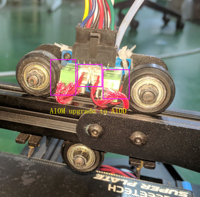

Anyone changed the 2in1out hotend with a 2in2out by using 2 heating cartridge ?
The hotend PCB doesn't have support for a second heating cartridge, but the motherboard does.
Where can I see the extruder cable pinout to attach the second heating to the motherboard?

You can refer to it:
1.You need to solder the pin for thermistor+heating bar
a10m upgrade to a10d-1.png (2.29 MiB) Viewed 6266 times

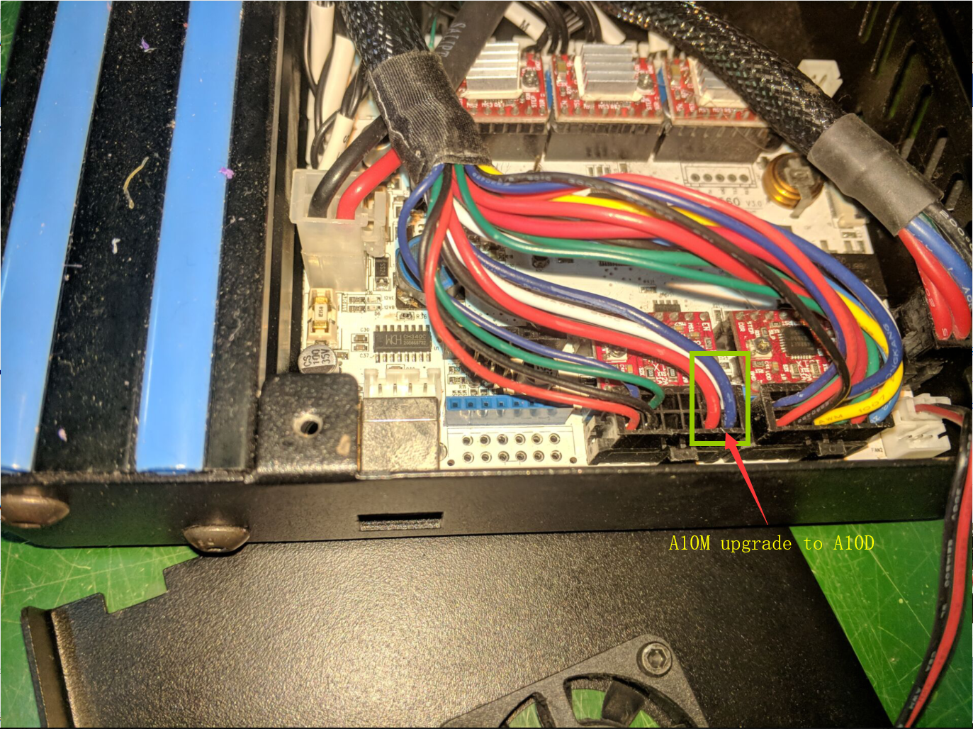

2.Replace the cable of extruder cable
3.Replace the old extruder extension board to the A10D type
a10m upgrade to a10d-2.png (846.56 KiB) Viewed 6266 times
