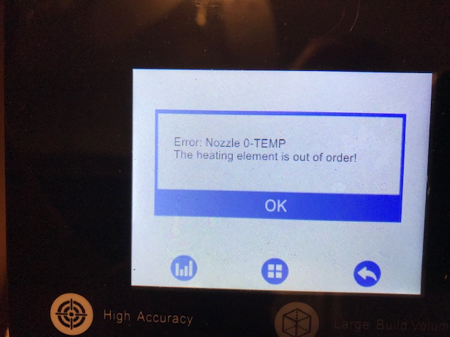

I have just gotten the printer to start actually printing correctly, then I get a stop of print due to the nozzle to stop heating with an error.
How do I go about getting this replaced? The printer is less than 3 weeks old.
A30 Nozzle stopped heating.

I got this issue actually a couple of times with different nozzles.
I dont know what causes this problem but I always got it when I used Cura for a longer period of time without restarting Cura and the printer.
After the restart the issue is gone for quite a while.
What Slicer do you use?
Re: A30 Nozzel broke
Hi, You may want to check if the nozzle of your nozzle is fully connected
and then check the resistance of the thermistor.
