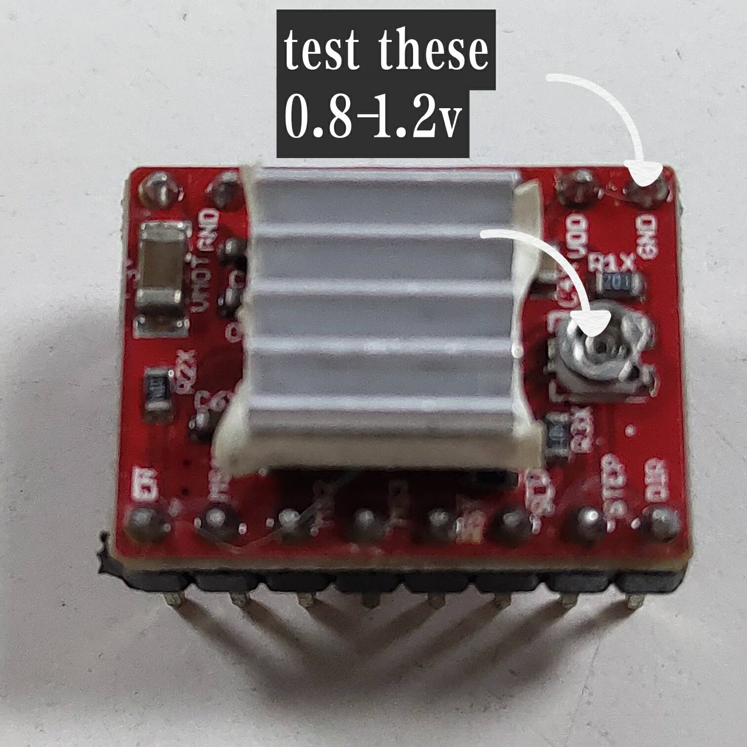

Is there a description of how to adjust driver board voltage if layer shifts keep happening?
Re: TL smoother add-on
Hi, You can refer to this for adjusting the driver board voltage:
A4988 测量位置.jpg (192.77 KiB) Viewed 11524 times
Increase clockwise and decrease counterclockwise.
I hope this can help you.

Thanks... I assume these are the drivers mounted on the mainboard in the noisy box?
(Just received my A10M yesterday. Already like it better than my A8, but it takes time to fine tune and work out kinks. Already retensioned the belts because they were pretty loose, but I still have layer shift, even at 45mm speeds)

I see the picture, which pins am i sticking the test leads on to check the voltage from the board for steppers? is the voltage the same with just the power on, or is it different when printing?
sorry if I ask a lot, i know enough about electronics to get me in trouble, i'm a newbie, not an expert.

You measure across the groundpin (top right) and the potmeter...

and BobaLives,regarding the measurement of the driver board voltage,
you need to pay attention to the operation of the printer when it is turned off.
Go to the measurement voltage range and measure with a multimeter
