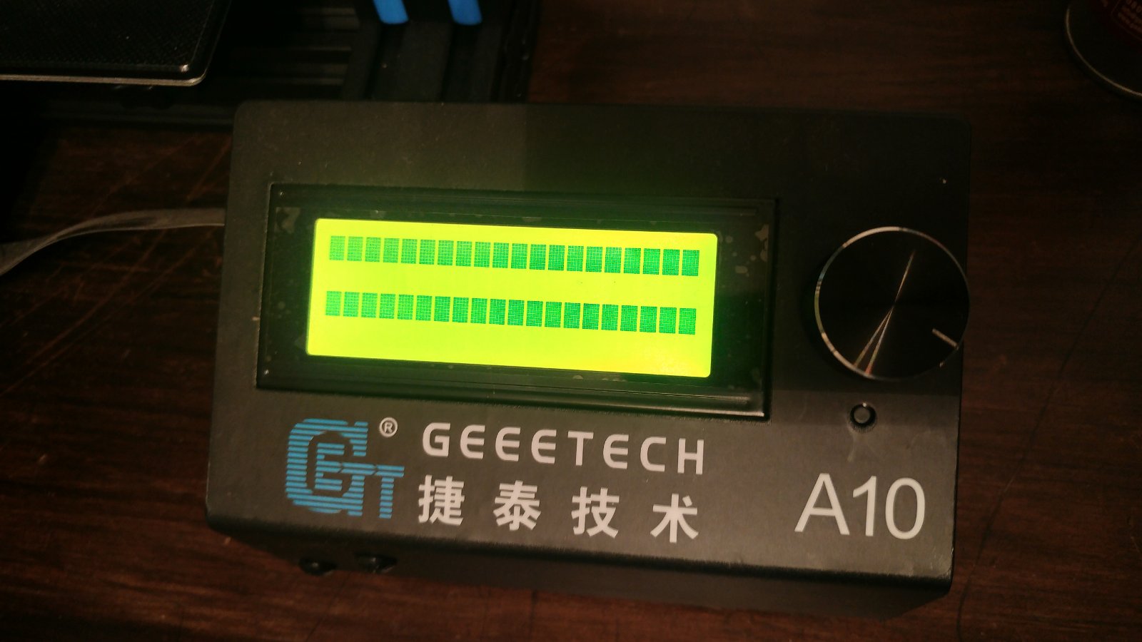

My Geeetech A10 was working ok. I stopped a print job and turned the printer off.
Later, when I turned it on it does´t start, and the display shows two lines of black blocks, as can seen on the enclosed image.
Any hint on how can I make it come back to life?
Any help will be much apreciated!
Thanks!

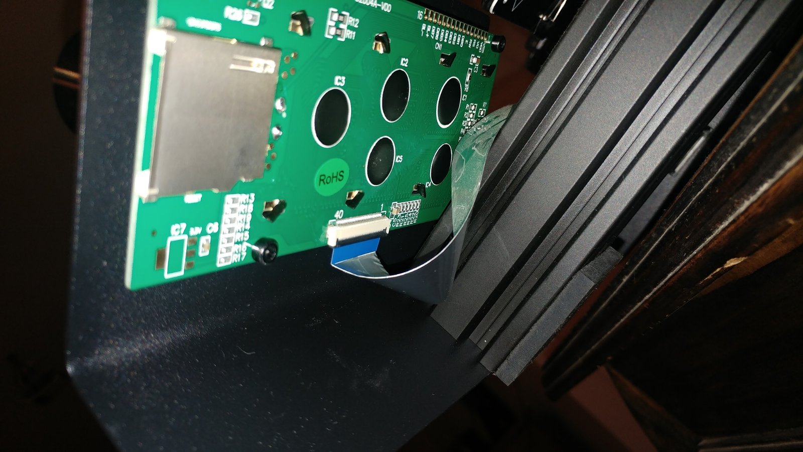

Hi, You can try 1. Reconnect the screen cable and see if the screen cable is broken.
2. If the screen is still not working properly after reconnecting, you can try to refresh the firmware.
I hope this can help you.
Re: A10 doesn't start
Hi William,
Thanks for your answer.
I think the screen cable is ok.
How should I proceed to refresh the firmware?
Thanks and regards.
Federico.-
Thanks and regards.
Federico.-
Hi, You can reconnect the screen line first. Poor contact may cause this to happen.
You can use this link: https://www.geeetech.com/download.html?download_id=30
to download the corresponding toolkits and files you need on the official website to refresh the firmware.
I refreshed the firmware and everything went back to normal.
