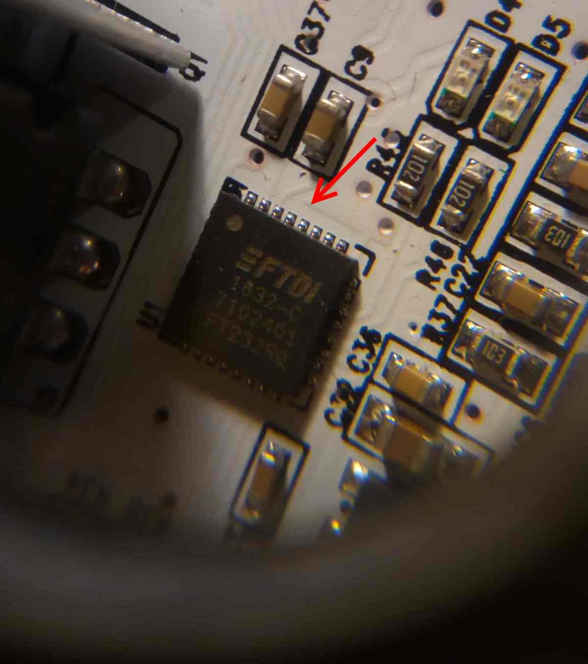

2) During the visual inspection I found serious two quality issues:
A) The FTDI chip soldering seems to be precarious, its terminals look like rusted and the solder paste seems like small balls not correctly bounded to the pads. I will try to take a picture when I'm back home today.
B) I found many drops of solder (tin) over the board.

Hi,which version of Arduino do you burn the bootloader with ? Arduino 1.0.1 will be more stable to do that.Besides,the situation of FTDI chip soldering is also the key factor of your case,post some pictures about it when you are back home.

I attach here one photo of the FTDI chip. It was not possible to take it from the chip's side to show the rusted pads, but it is possible to see here how the tin has created balls over the PCB pad surfaces.
One again, I have not changed the firmware running on the CPU, neither the bootloader nor the application.
Photo of the FTDI chip.
