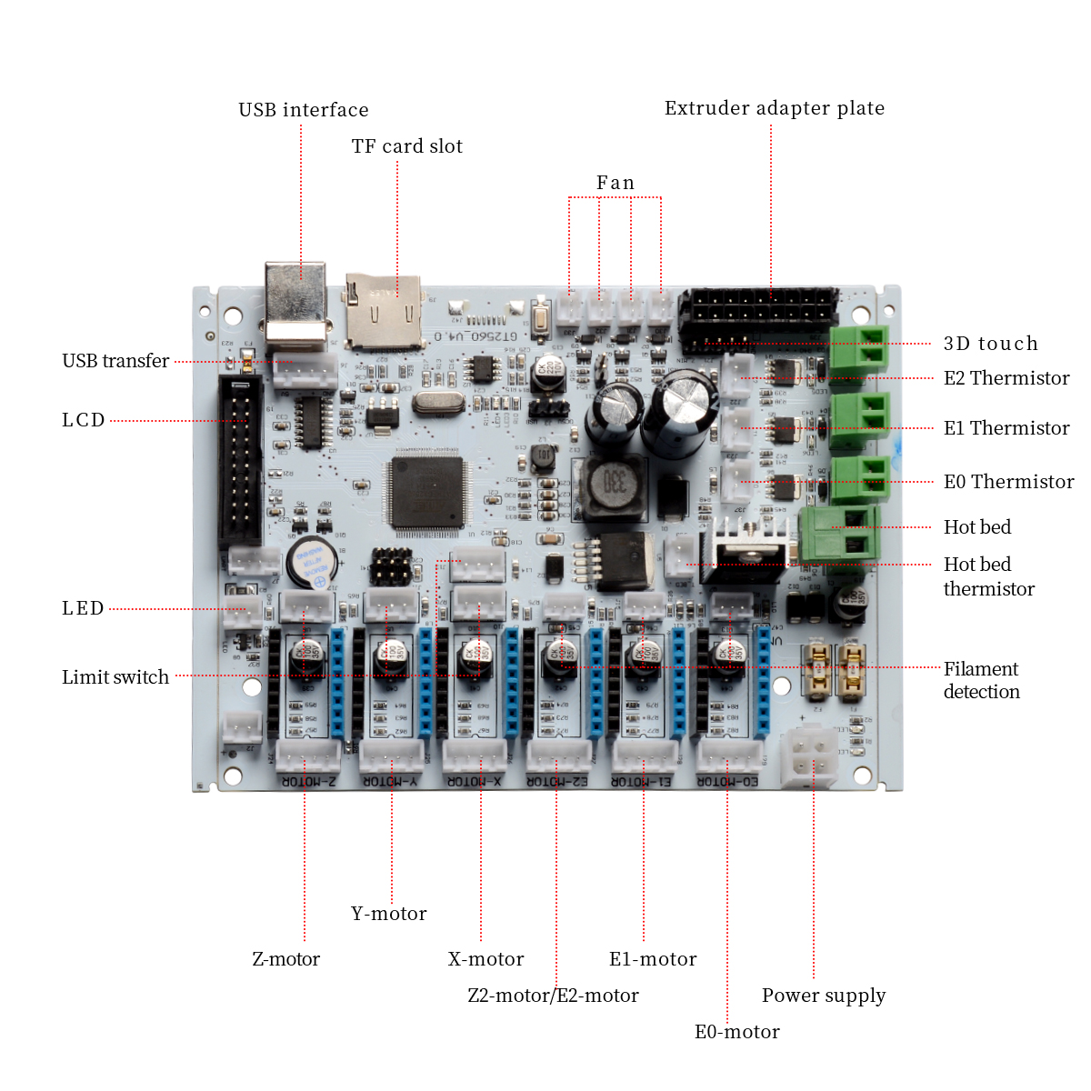

About the wiring of the motherboard of GT2560 V4.0

Are there any PWM pins available on this board that could be used to control RGB LEDs for example?

That is a nice layout for all the common connections to drive a printer.
I have been looking for information regarding where I may connect a USBASP board to flash a new bootloader on a GT2560 v4.0 motherboard. This wiring diagram has not helped in this regard. I have seen references to connections at the LCD or by putting an SD card in the slot on the LCD board on other 2560 boards. Generally, the firmware upload is very straight forward, until the avrdude shows up to throw some error messages around.
Is there any information regarding how to connect a USBASP board to the GT2560 v4.0?
The 3 x 3 pin header next to the y stepper driver seems like a likely candidate, but there is no pinout listed.

does anyone have the pinout of the LCD connector

Hi, congratulations for this board, it's very nicely designed and well engineered. Would it be possible to receive the schematics of the board?

Dear sir,
The pin for the Z-switch on the GT2560V4 seems sometimes faulty, and it seems that there is a free pin for switches on this schematic you posted. Unfortunately, since the firmware for the A10T is only on hex, one cannot exchange both pins in the software. Would it be possible that:
1. You inform the community about the advances of having a source code of this board for Marlin?
2. Inform the community about the pins connecting the mega2560 to the different peripherals of the board available.
I just bought the printer last week and am already having this error, which is very unfortunate since I wasn't feeling like having to solve these issues.

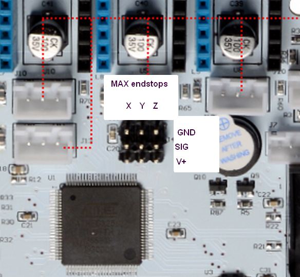

Where can i put in a x max stop?
1zRadio
Joined: Fri Oct 12, 2018 11:15 am
Re: GT2560 V4.0 motherboard wiring diagram
Post by 1zRadio »
M klok wrote: Sat May 09, 2020 9:53 pm Where can i put in a x max stop?
MAX endstops here
GT2560_V4_MAX endstops
