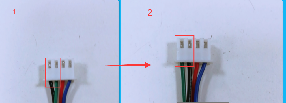

The truth is that version 1.0.5 of your firmware works quite well, but i need to change the A4988 for some TMC2208 ( my wife cannot bear the noise of the printer and the truth is that I understand her ) I would have to be able to edit that firmware to change the direction of rotation of the motors and I think something else, although if you tell me that only Physically reversing the connectors on the motors would work fine, I could try it.
Re: MARLIN 1.1.9 FOR I3 prow
Hi,you can change the black and green line order as shown.

Thank you very much, I will try it as soon as the TMCs arrive
