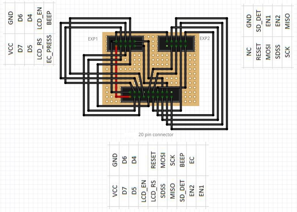

I made this schematic to connect a reprap full graphic smart controller to the 20 pin connector of the GT2560 V4. Could anyone tell me if it could work?

I tried the same wiring diagram, and only got beeps from the integrated speaker. I realy would like to connect an graphics lcd to this printer
Re: GT2560 V4 & 128x64 Full Graphic LCD
Sorry, we can't test that either.

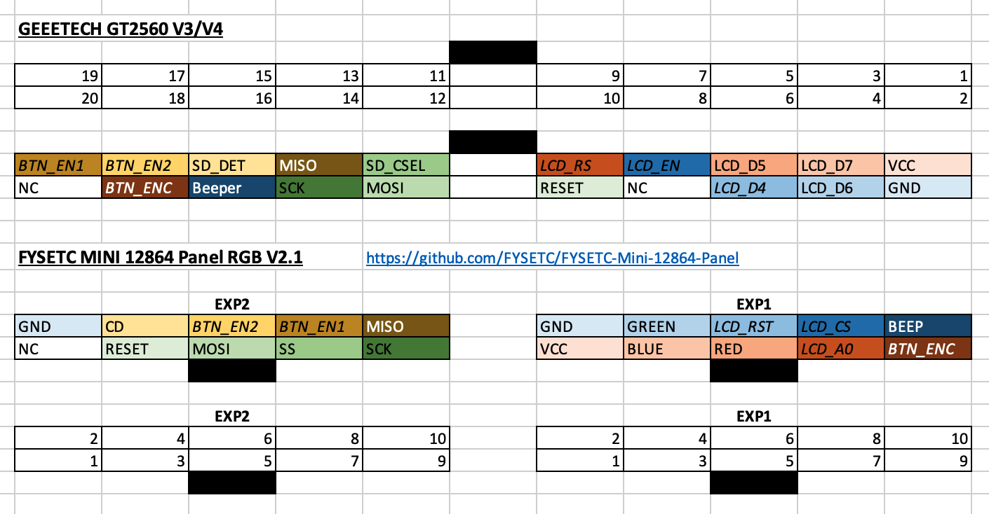

Try to invert EN1 and EN2 pinout wiring on exp2 connector
I have followed this FYSETC MINI 12864 Spec for EXP1 / EXP2 and it works fine for me ==> https://github.com/FYSETC/FYSETC-Mini-12864-Panel
In this spec EN2 is on pinout EXP2-6 and EN1 on pinout EXP2-8
