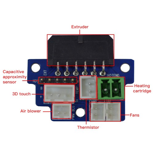

I have a A10 and want to find out how to control the fans around the extruder.
The one marked as AIR BLOWER is controllable in the slicer / Repetier without an issue. This is the one which cools the part printing.
However I cannot find a way to control the speed of either of the ports marked as Fans (see picture)
It's starting to annoy me.
I've done all the usual things by changing the printer and slicer set ups but no luck.
Re: A10 Fan control
Hi,the blower is controllable, and another fan that cools the heating rod is uncontrollable. It will keep turning when the machine is turned on.
