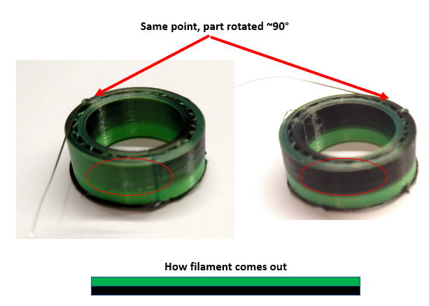

Okay, sounds like you have it figured out and could enlighten the rest of us with your filament settings. I'll illustrate the issue.
As shown in the following two images of the same simple cylinder that was intended to gradient by 10% from green to black. Each step change in mix ratio was to occur every 10 layers. I stopped the print once I saw it had mixing problems. As shown, when two filaments are simultaneous feed into the nozzle they come out not homogenized but merely adhered to one another (as in the lower diagram). This results in seeing the green at certain locations of the part and black at other locations (red circles). Clearly this is a result of how the nozzle is positioned and traveling. If they were truly mixing to some level of homogeneity than this directionality wouldn't occur.

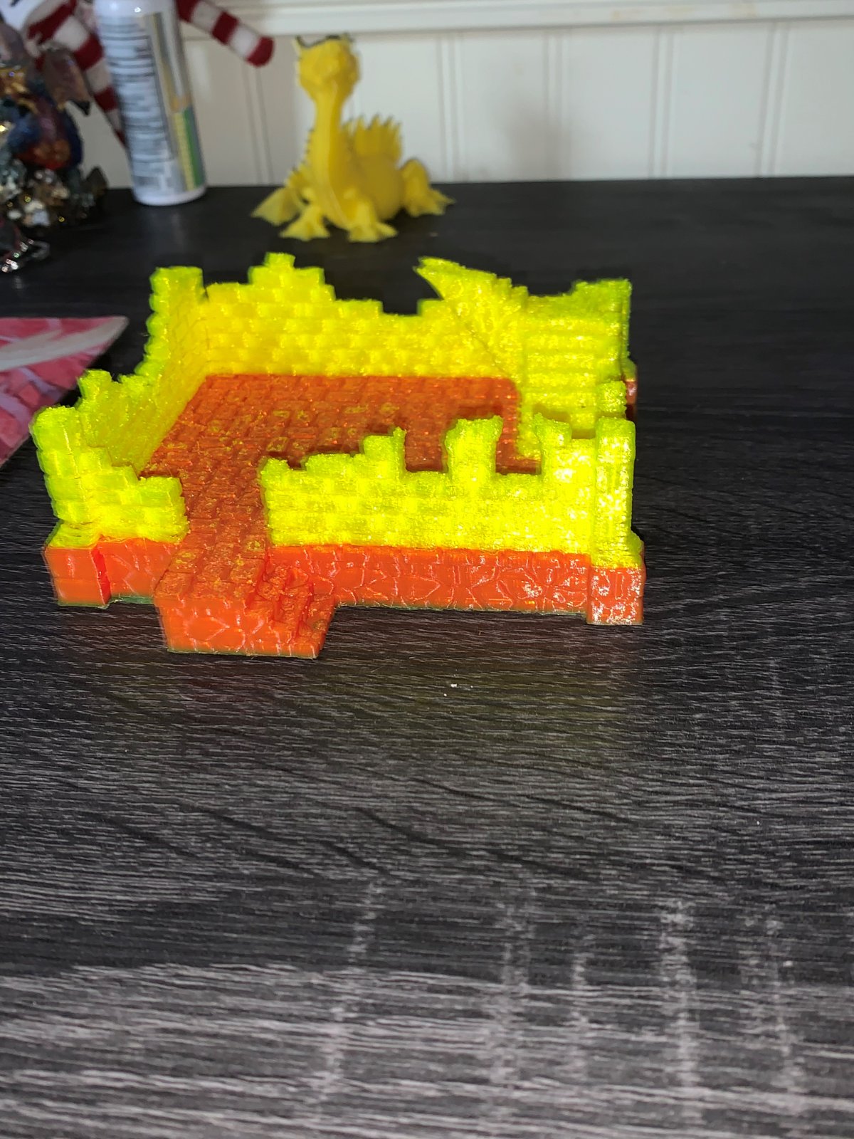

Post by BadShep »
You can get color mixing to work properly with this printer and the a10t but you need the right filament. Any opaque filament will not work, so most PLA is out of the question for proper mixing with these printers. If you get translucent filament in the colors you want it will have the desired effect. I have used https://www.amazon.com/dp/B0746FL41L/re ... UTF8&psc=1 for this. Mechanically, the filament still gives the toothpaste effect but, because it is transparent it lets you see the second color through it and gives the appearance of proper mixing. For this print I used the yellow and red filaments in a 50/50 mix for the orange, and then pure yellow for the top,and for the brim and the first few layers i used 33%blue, 33%yellow, 33% red. There are flecks of yellow at the top of some of the floors due to not measuring the wall height properly, but there is no toothpaste effect visible on print, look at the stairs to see, its a consistent orange
color mix.jpg (349.3 KiB) Viewed 6163 times
With transparent filament you can use the provided geeetech color mixing software to get the color you want, or you can set up virtual extruders with the mix you want in cura and get harder color switches like I did here.
