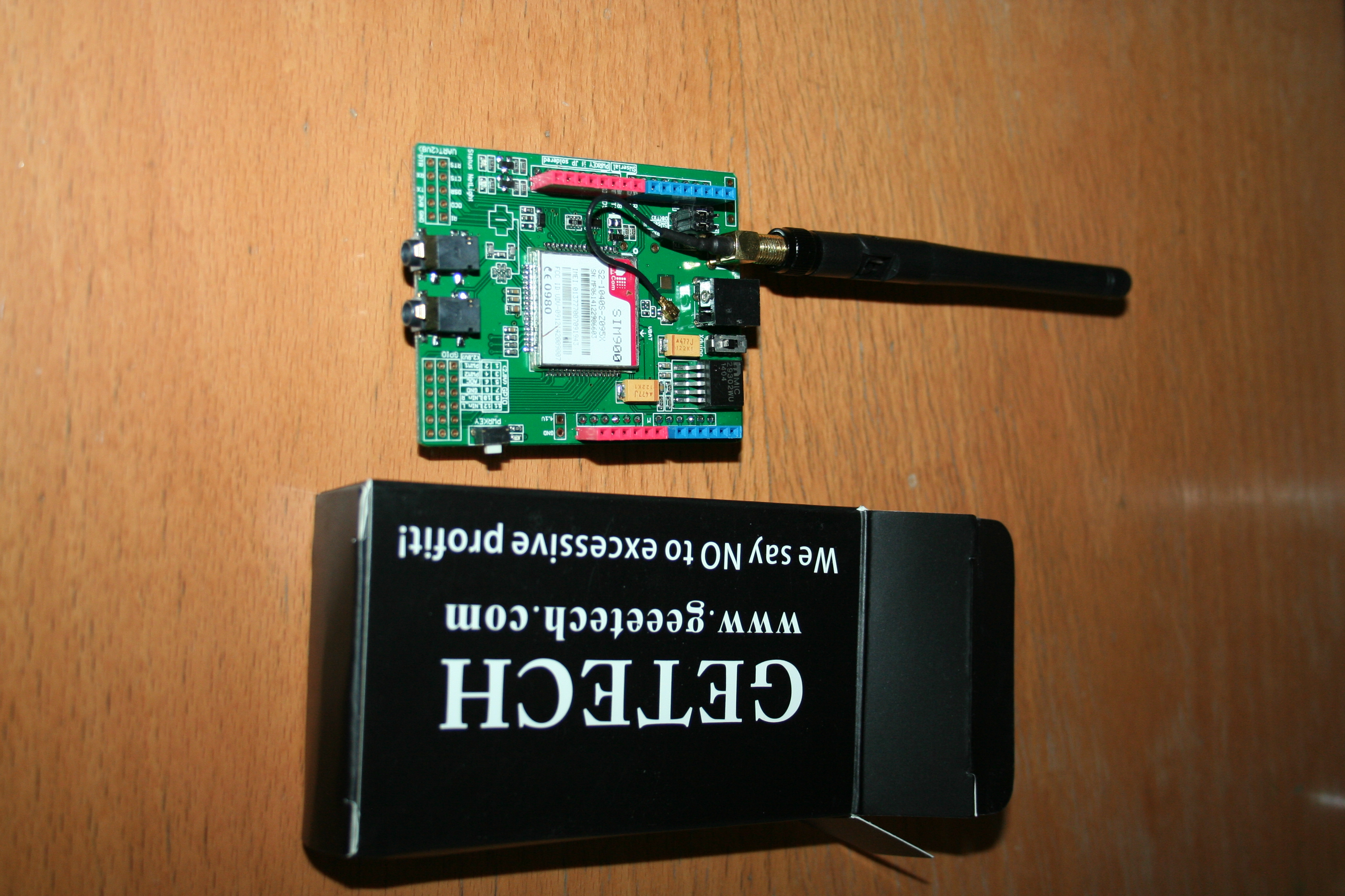

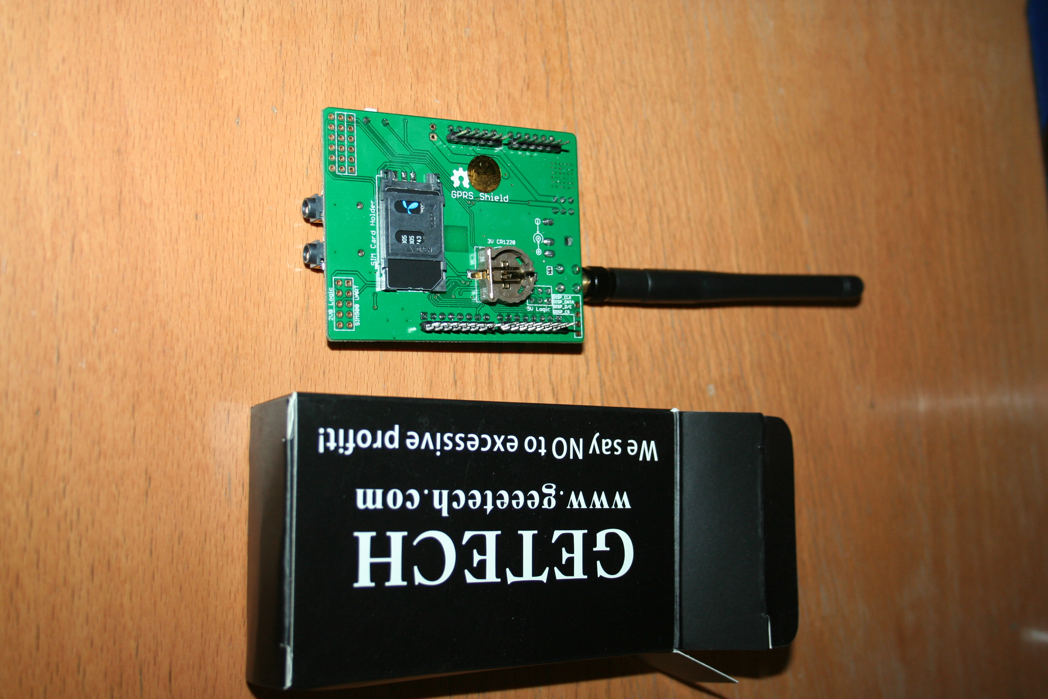

Here are the high resolution photos.
(3.07 MiB) Downloaded 81 times
(3.05 MiB) Downloaded 81 times

Dear friend,
We don't understand the meaning of the photos.Could you please tell me what's the problem of the GPRS board you received? Looking forward to your reply
