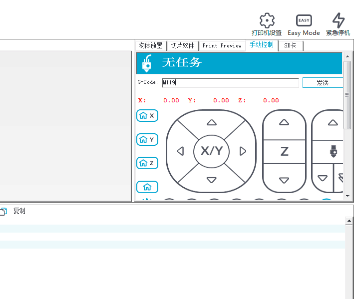

The first thing is connecting your printer to your computer with USB cable, then open repetier host. If you don't have that, you can click this link to download.
https://www.repetier.com/download-now/

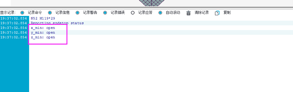

Connect your printer, place all axis in the middle and then input G code "M119"
You will see this
X_MIN:open
Y_MIN:open
Z_MIN:open
It means all endstops function well

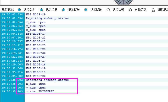

Then I will take Z axis as a example, press Z axis endstop with your hand, hold it, input G code "M119" again. you can test other axis in this way.
If your Z axis endstop can work well, you will get this.
X_MIN:open
Y_MIN:open
Z_MIN:TRIGGERED
If it still shows
X_MIN:open
Y_MIN:open
Z_MIN:open
It means there is a problem on your Z axis endstop, you need check the cable connection. you can also test it by replacing it with a good-working endstop .
