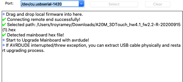

I recently purchased an A20M and the 3D Touch V3.2. I'm trying to upgrade the firmware so that I can use the auto-level feature, but I can't seem to figure out how to do it. I've watched several videos and read everything I could find. I'm hoping someone can help.
Marlin 1.1.8, GT2560 V4.1.
I keep getting this message:
Screen Shot 2021-08-17 at 8.33.19 AM.png (43.51 KiB) Viewed 3638 times
Any help would be appreciated.

Re: A20M - Firmware Update Issue
Post by Admin »
Hello, you did not choose the correct COM, please refer to the link below to install the CH341 driver.
http://www.geeetech.com/forum/viewtopic ... 974#p81974
