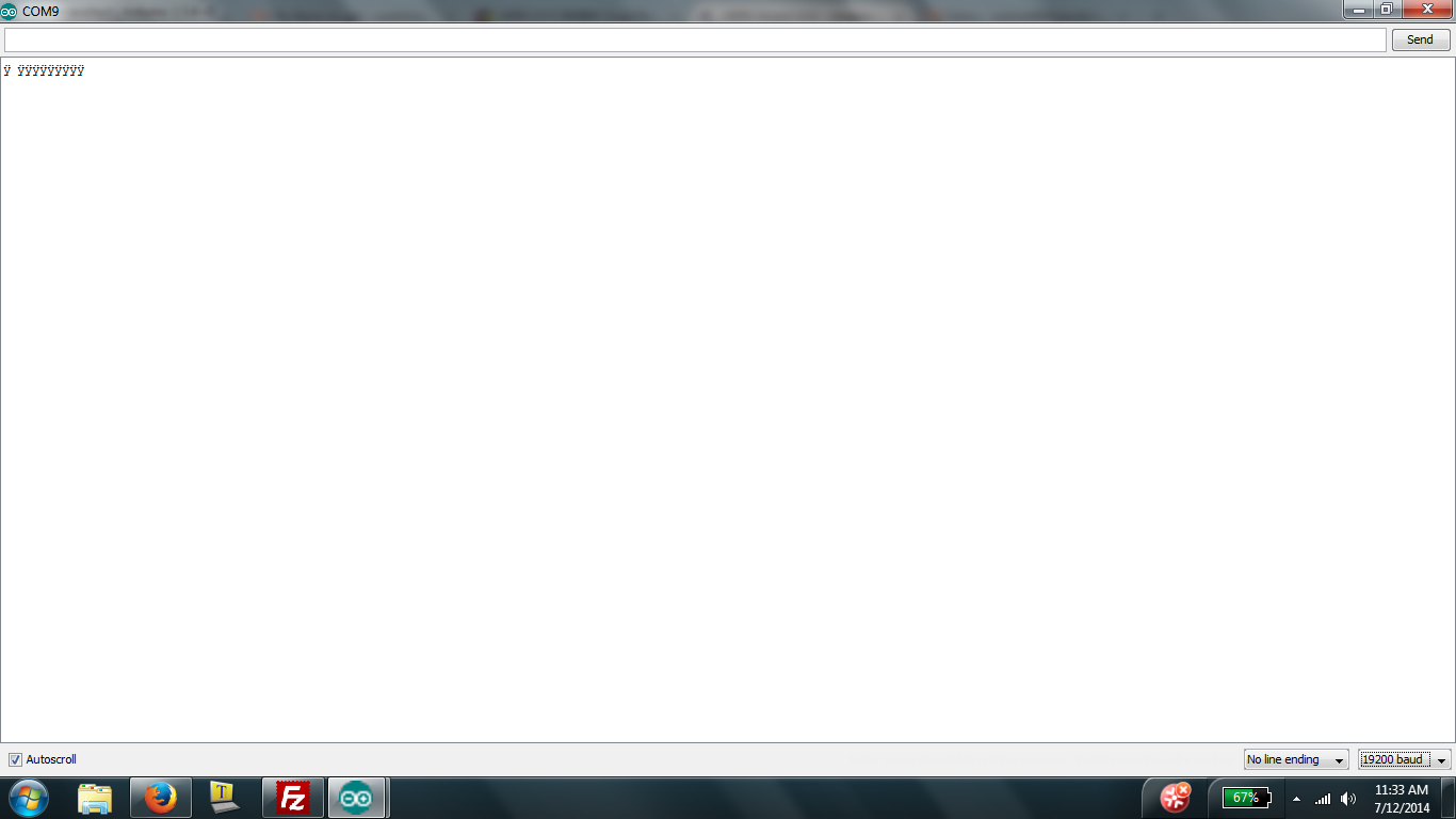

Output when power button is pressed
I just bought a GPRS shield from ebay (http://www.ebay.com/itm/321335842823?_t ... EBIDX%3AIT). I hooked it up to a Arduino UNO and now trying to use the serial monitor in the arduino IDE to communicate with the shield.
I used the test code given on your wiki (http://www.geeetech.com/wiki/index.php/GPRS_Shield_V2.0) and have connected the jumpers on the software serial side.
The shield is being powered from a arduino uno and when I press the power button (see attached screenshot for output) the red led turns on and stays on. The green LED as indicated turns on every 3000ms and then turns off.
I have attached a unlocked sim card from t-mobile to it. No external power supplies have been used.
Even after doing all this the shield is not responding to any AT commands.

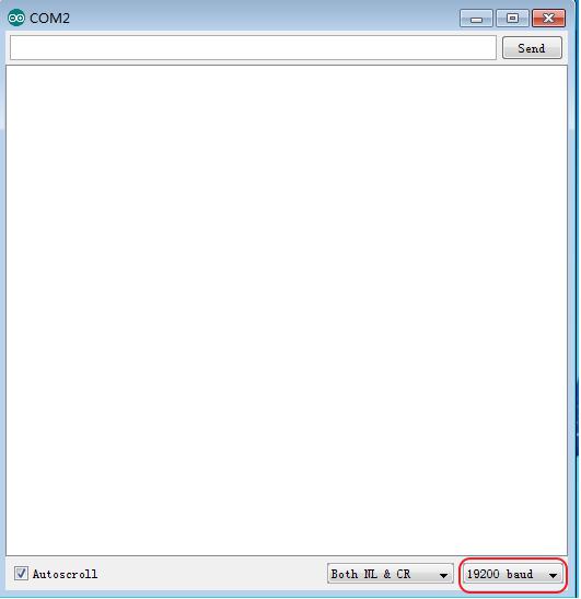

According to your question, could you please be patient and try to test the items according to the following steps:
1.select the right baud rate which mate in your code
“Serial.begin(19200)”
If not receive right answer form serial monitor yet,maybe you shouid set GPRS’s baud rate via AT commands.
AT+IPG=19200 and serial monitor will return you a value “OK ”

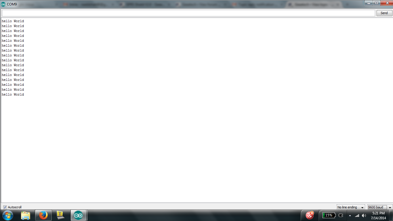

Could you plaese also check whether there is a problem of the serial port or not? Please upload the following code for Iduino UNO.
void setup()
Serail.begin(9600);
void loop()
Serial.println("hello World");
delay(1000);
If the serial port is normal, the serial port monitor data will prints hello world.
Please have a try. Waiting your reply. Best regards.

I have matched the baud rate from my code to the serial monitor. The baud rate for both is 19200 as mentioned on this link (http://www.geeetech.com/wiki/index.php/GPRS_Shield_V2.0).
Also the second post says that I should test the serial communicatio with Arduino UNO. I tested that and the result is provided here.
Out put of hello world program

Dear friend,
Thank you for your reply.
According to the result you sent, the serial port has without problem.

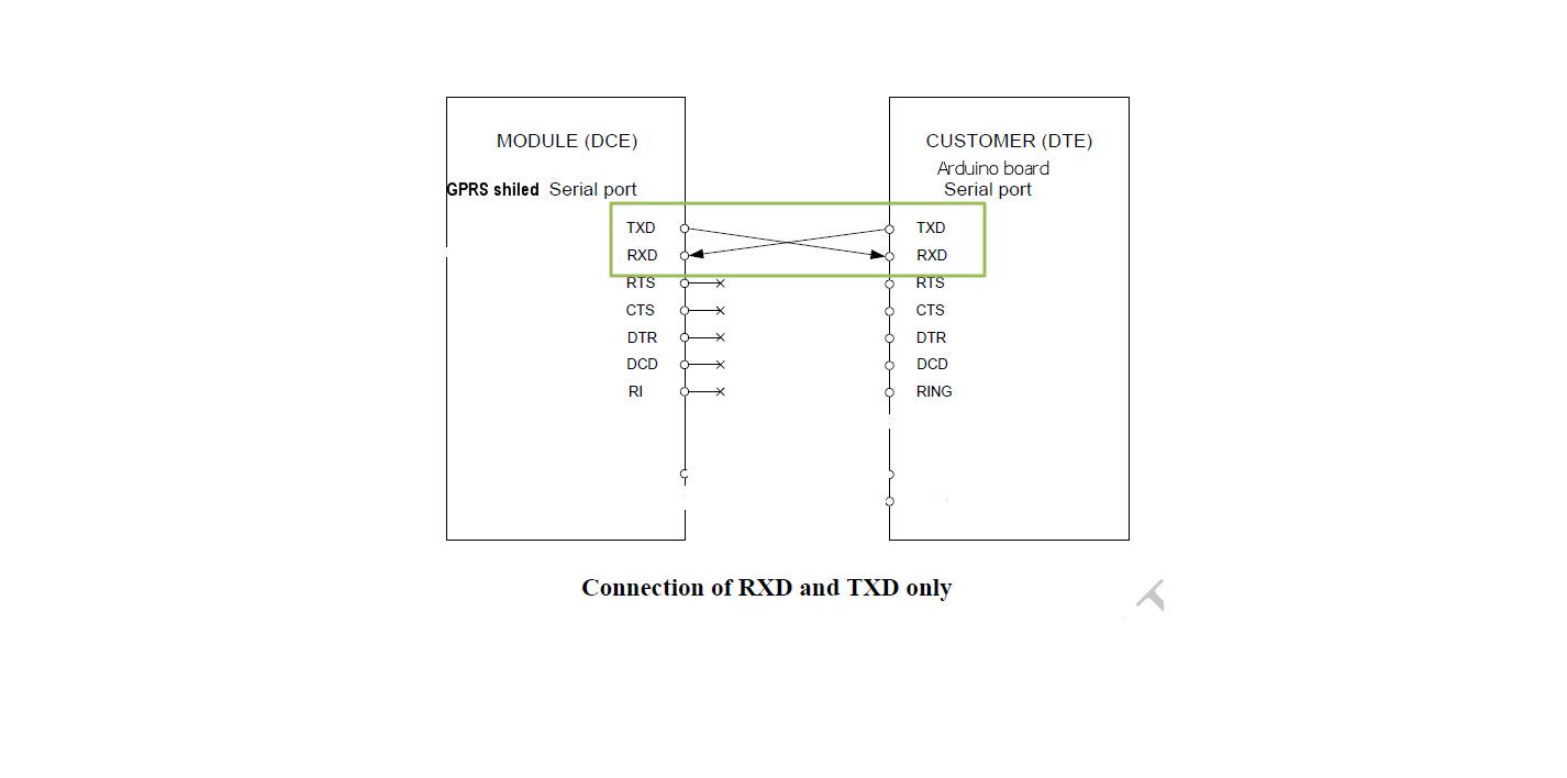

1. Please do not use the way of sortware to test the GPRS module.
2.Connect GPRS with Iduino UNO
Iduino UNO GPRS shield
RX ----------------TX(D8)
TX-----------------RX(D7)
send the main AT commands
such as
AT // return value OK
AT+phoneNumber; //nake a call to phoneNumber
AT+IPR? //return GPRS's baud rate
After you finish tested, please don't forget to tell me the details.

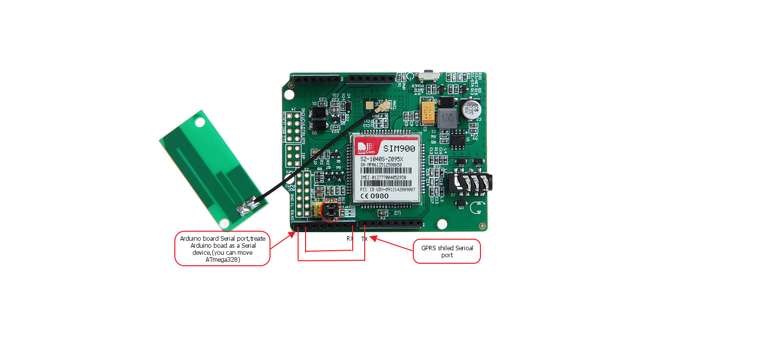

Lemon
Posts: 40
Joined: Thu Jul 03, 2014 9:13 am
Re: GPRS shield not responding to AT commands
Post by Lemon »
Dear friend,
We treat Arduino board as a serial device when we use AT commands.
By default, the status of the Jumper Cap is close to D7 and D8, it has not connect directly to D7(RX) and D8(Tx).
What we do is just for communicating GPRS shield with PC(Serial Monitor), not for communicating with Arduino board.
