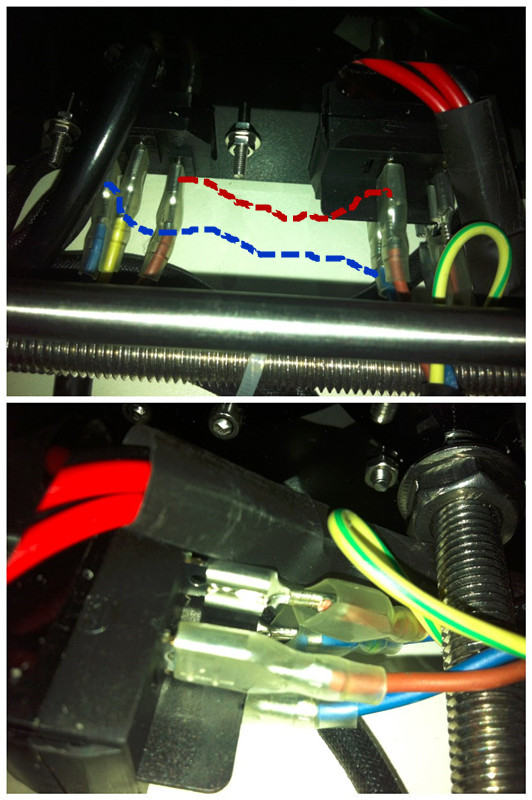

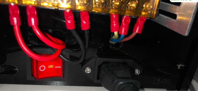

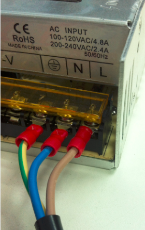

The picture below shows how to connect the power unit.
If you still have any problem, reply me. You'd better add a pciture.
