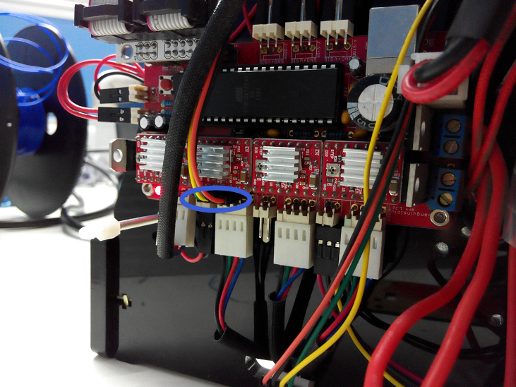

^^^ I would ask that you post a photo of this as I see only 4 motor connections (X, Y, Z and extruder). I do not find any place accessible for a second Z motor.

Please look at the picture. The dupont in the ellipse is used to connect one of the z motors.

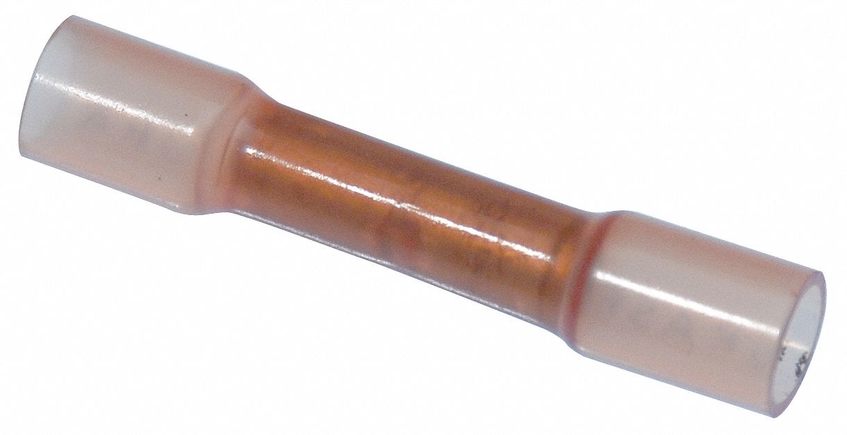

4.) twist together and tin with solder the 2 black wires, 1 each from the Z axis motors. Once connected insert this pair of wires into a solder less "butt connector" and crimp them together. http://static.grainger.com/rp/s/is/imag ... 01?$mdmain$
