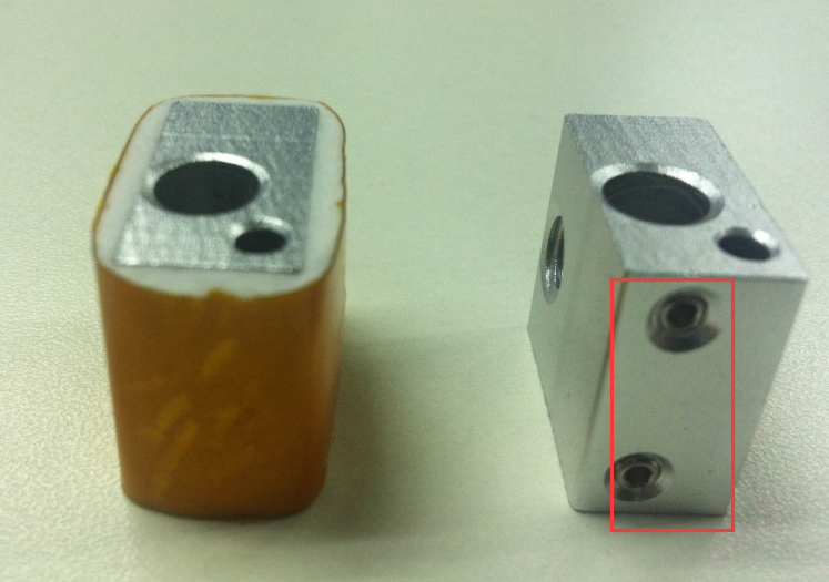

Hello,
My hotend refusse to heat. I can see the temperature state on the LCD screen
I deeply think the cartridge heater (12V 40W) to be responsible of the issue.
I bought a new one but I can't remove the old one from the mk8 extruder.
How do I have to process to solve the problem?
Thanks
Aubin

zhangxueyou
Posts: 1405
Re: Cartrige heater seems to be dead.
Post by zhangxueyou »
As you can see in the picture, there are 2 hole on the edge side. Loosen the screws.
Post by aubin80 »
Thanks for the help.
Do I have to buy a new coton hotend insulation or it can work without it?
zhangxueyou
Posts: 1405
That is used to slow the cooling speed of hotend when heating. My opinion is you don't buy a new one. But please be careful, don't touch it when heating.
