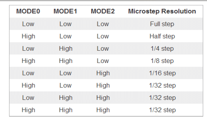

I think you set the microstep of x and y motors as 1/32.
Usually, when you use A4988 as driver, all the jumper caps should be plugged, and microstep will be 1/16.
But if you are using DRV8825, you need to unplug some caps. Look at the picture:
microstep of 8825.png (81.82 KiB) Viewed 10120 times

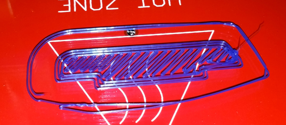

Ok I've changed it to 1/16 by disconnection caps 1 and 2 now it seems like it is travels the right distance but now I have new problem
how to fix that?

The distance between between nozzle and hot bed is not low enough.
The first layer is very important for the whole item.
When you are priting, I suggest you adjust the distance by rotating the 4 screw anticlockwise at the 4 corners of bed. No gaps between printed lines is good.
The first layer should be flat. I suggest you smear a layer of glue to make the filament stick to bed.
