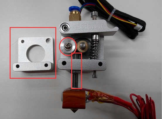

I have had that printer more then month (MK8) so now I have upgraded it totally. It works like a clock now.
Anyway
I would like to go now to the 3mm filament, do I need also new feeder or just wheel, throat, hotend and what size of nozzel ?

Hi, you need to change the wheel, the throad(ofcourse including PTFE tube), and MK8 support:
