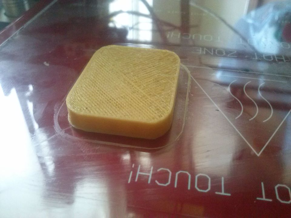

iron7
Posts: 19
Joined: Mon May 18, 2015 7:25 pm
Re: Printer stops randomly
Post by iron7 »
I printed the object, the result was satisfying. So the problem is generated from gcode ?

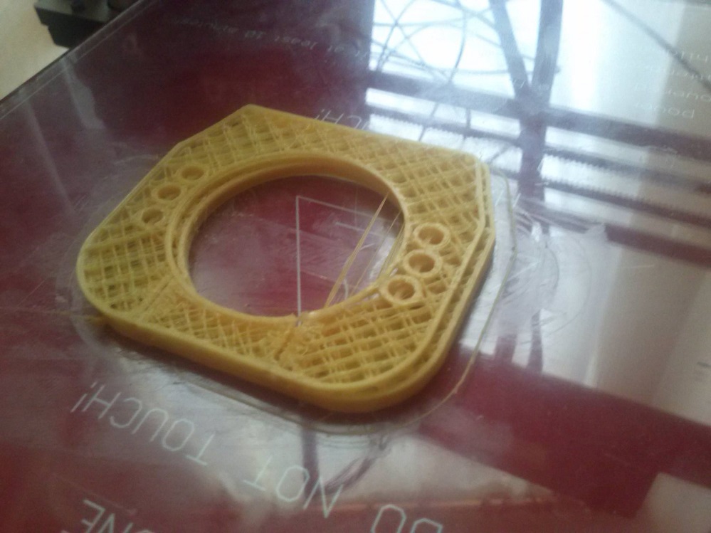

iron7
Posts: 19
Post by iron7 »
I tried to print the holder, you can see the result in the photo below. I printed with PLA because i haven't ABS, the extruder temperature was 200 C and the bed at 60 C. The problem keeps on ...
