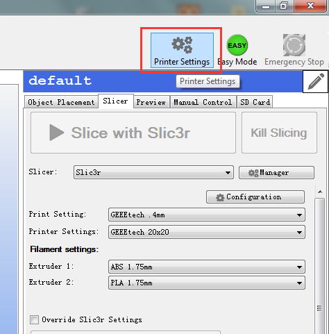

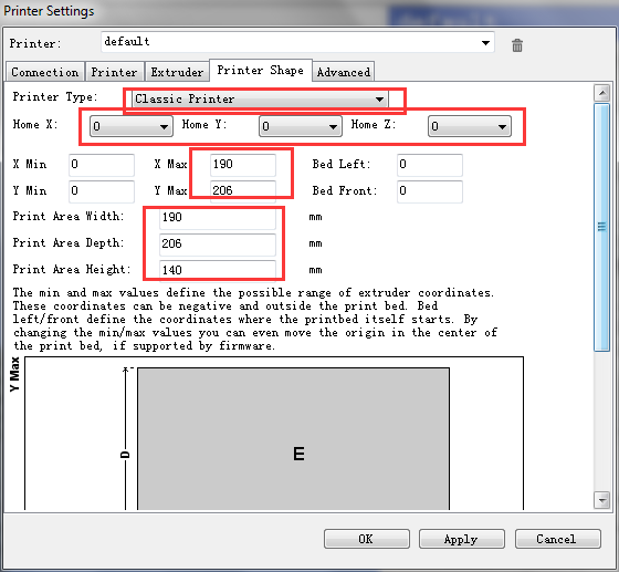

Hope it will help you:
printer setting1.png (31.25 KiB) Viewed 14763 times
printer setting2.png (25.19 KiB) Viewed 14763 times
