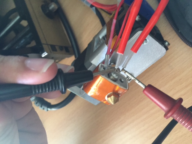

I checked the connection, it is good but I checked ohm of the extrude heater ,it is broken ( it doesn't have resistance compare with the bed heater, it is good). How can I change the heater and where can I buy (I have just try to inject in the first time).
Thank you
check ohm of the extruder heater

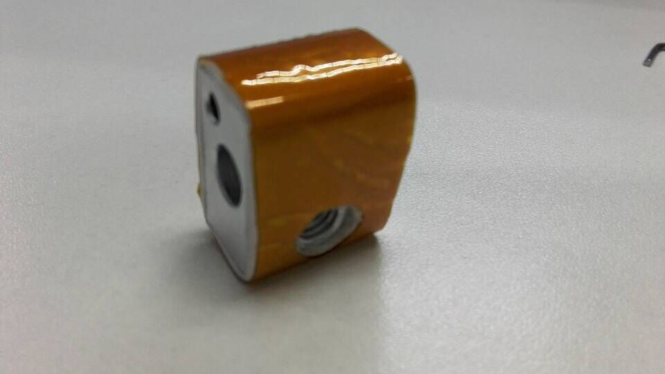

i think the heater strip was burned out,you had better to replace a new heater strip.

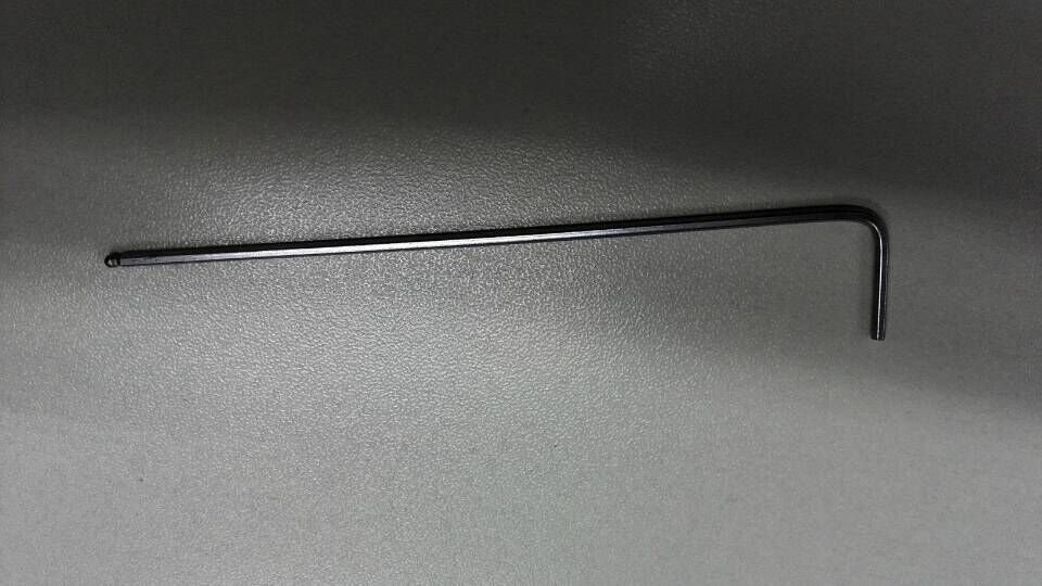

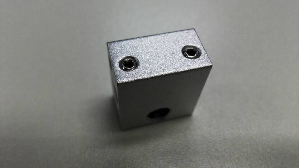

look at the picture. There are 2 small screw in good packing heater.Using hexagonal socket nut to loose the screw(look at picture 3).And then you could take out the heater strip.
picture1:packing heater

picture3:heater
picture3:heater
extruder heater.jpg (40.17 KiB) Viewed 10047 times
