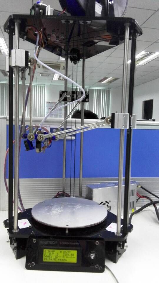

hi,johnp,sorry for my presentation mistake ,i mean i will modify the parameter in wiki .
the real specification is
rint Volume: cylindrical,D:190mm,H:200mm.

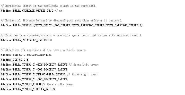

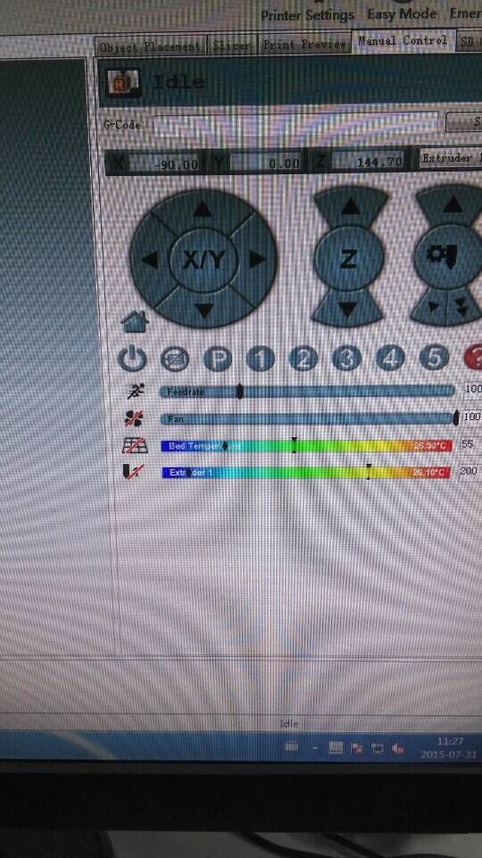

please look at the pictures.in my repetier host,i can move x to -90.
and in the firmware DELTA_PRINTABLE_RADIUS is defined as 90 ,it was to protect the delta G2 from over-distance when moving,so if you want to get the prints of which radiu is 95,you can modifiy it in the firmware.
if you have any question,please contact me.

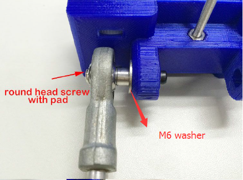

Re: Actual maximum print size?
hi,it seems that the washer is assemble in a wrong way.the correct assembly is like what display in the picture.Aeonster wrote:Hi,
