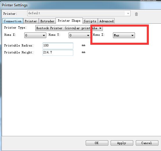

hi,did you select home z as max.
- QQ图片20150730153241.jpg (32.33 KiB) Viewed 18427 times

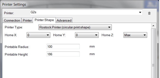

Hi, yes, i have home Z set to max.
When I run G29, the Z axis stops and the head tries to go outside the boundaries.
It seems like the firmware calculations are wrong.
Please send the latest firmware.
- gtech_PrintSetting.jpg (42.34 KiB) Viewed 18399 times
