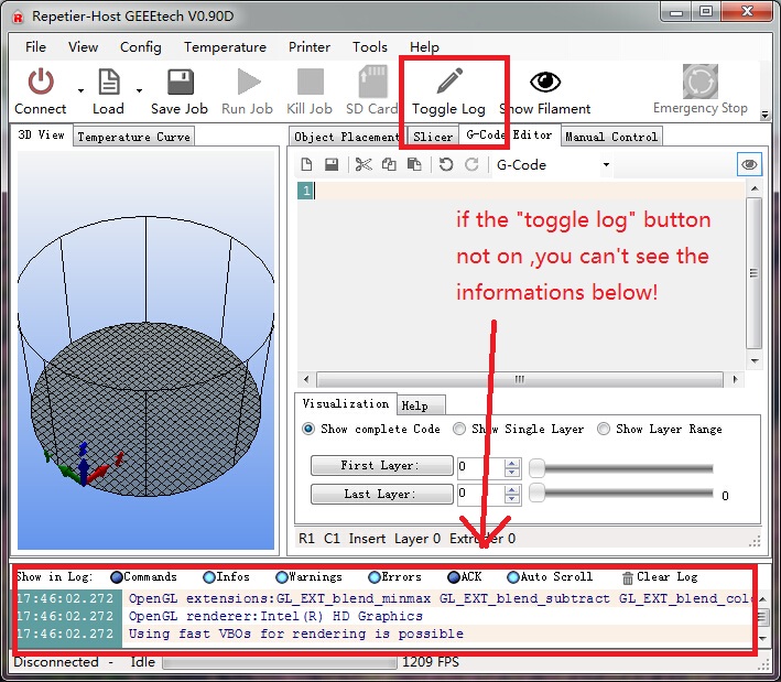

1) M119 show nothing ? did the "toggle log" button on or not ?

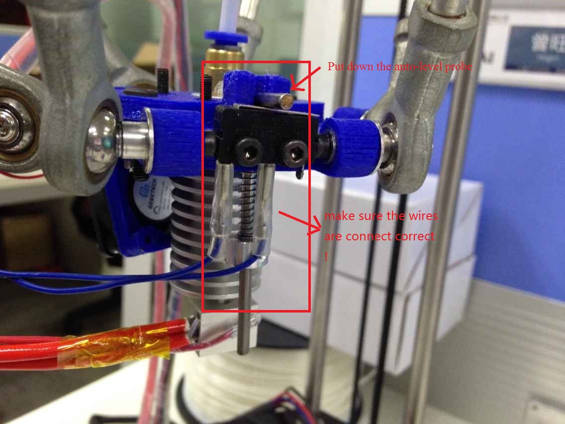

2) before you start G29 ,have you done the 3 steps ? especially step 2, see as pic bellow.
1. Homing the printer
2. Put down the auto-level probe.
3. Send M119 command

- toggle log.jpg (170.56 KiB) Viewed 6424 times
Re: M119 does nothing(mini g2)
ok good idea the log button thanks marc! i have donde the homing fine and the g29 but now im very lost because i dont undertands to much the instructions when i do the probe points the machin begin to go dow until crash with the bed, with auto leveling the machine arrived to the point with ni crashes but begin to the points up and up and up and finally never touch the bed, marc heeelp im so near to finish is like to make a nasa rocket my godxD
