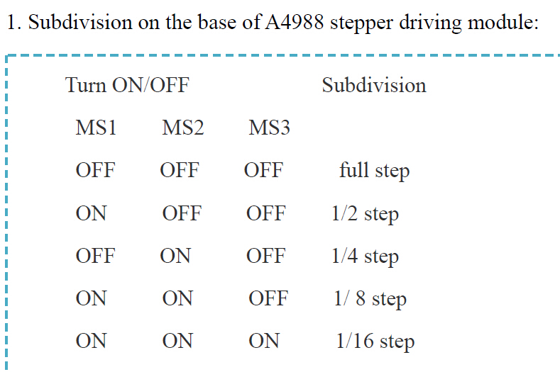

If you remove the giude tube, and do not plug the filament into the hotend, manually extrude 100mm, how about the actual extrude length?
And check the driver subdivision of the extruder see if they are correct.
