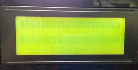

Two rows of blocks across the screen. Reset button doesn't appear to have ANY effect.

Back to square one. Attached is a photo of my LCD. The reset button still does nothing. I have shut everything off and re-started the printer. No joy.

For LCD2004, if you get the backlight and two rows of rectangles as the picture shows, it might be the wrong settings of firmware, you should delete the “//” from this line of the code“//#define REPRAP_DISCOUNT_SMART_CONTROLLER” and upload the firmware.

- QQ截图20150921145609.jpg (99.27 KiB) Viewed 15639 times

And do you add "//" before the line code "#define REPRAP_DISCOUNT_FULL_GRAPHIC_SMART_CONTROLLER"? If you only delete the "//" for LCD2004, and didn't add it to the line for LCD12864, you'll still get those blocks.
