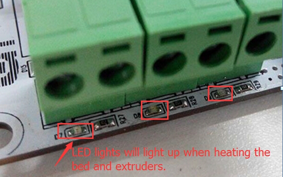

Does the LED lignt under the hotbed socket lighted up when heating?

The LED light does not come on anymore. Switching it with the extruder thermister did not help. Kind of bummer since it was only my third print.

"The LED light does not come on anymore."

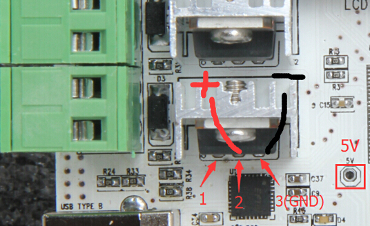

LED lights does not come on, so I think the mosfet of your hotbed that controls the heating it dead.You can check the mosfet as follows: use the multimeter to measure the voltage between pin 2 and pin 3 of the mosfet, when heated up it is 0V,and when not it is 12V. If not , then it is dead. the mosfet type is as follows, you can buy one in your nearby electronic store and replace it.
name specific type
mosfet TO-220 STP55NF06LTO
