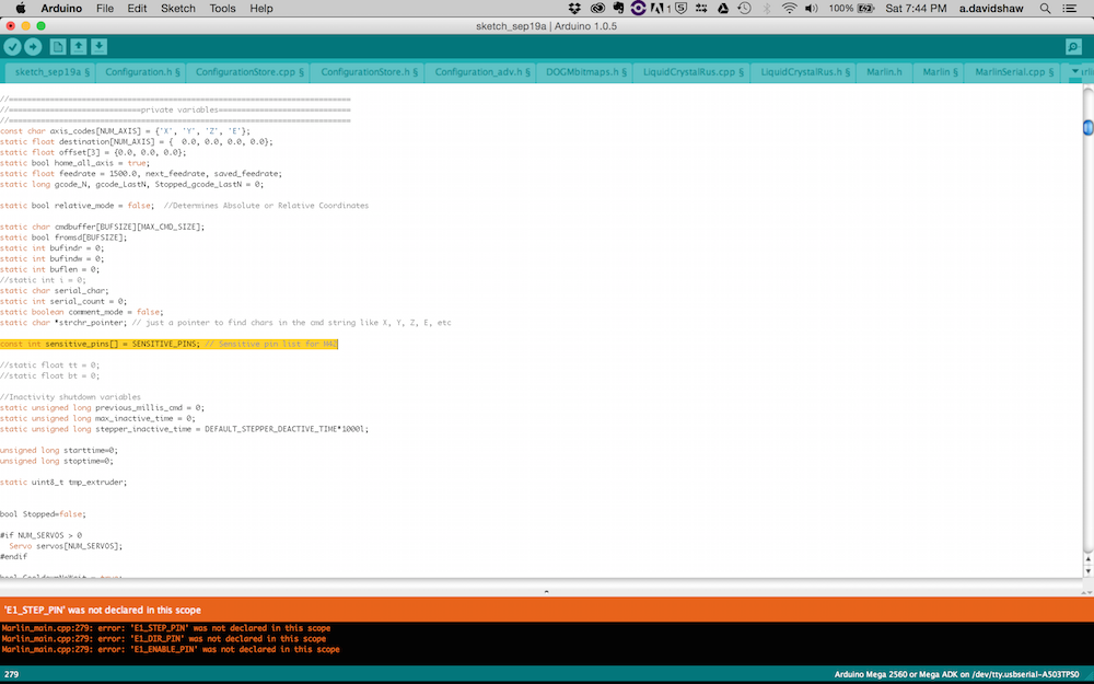

I already have the proper motherboard selected. I tried to compile it but I get this error. Any suggestions?
Marlin_main.cpp:279: error: 'E1_STEP_PIN' was not declared in this scope
Marlin_main.cpp:279: error: 'E1_DIR_PIN' was not declared in this scope
Marlin_main.cpp:279: error: 'E1_ENABLE_PIN' was not declared in this scope

Did you add all the files in the marlin folder into the arduino ? If you did, how about using arduino version 1.0.1?

I installed Arduino 1.0.1 and I received the same errors. I went as far as to install 1.6 and here is what it says, below this is the code in Marlin that is incorrect.
