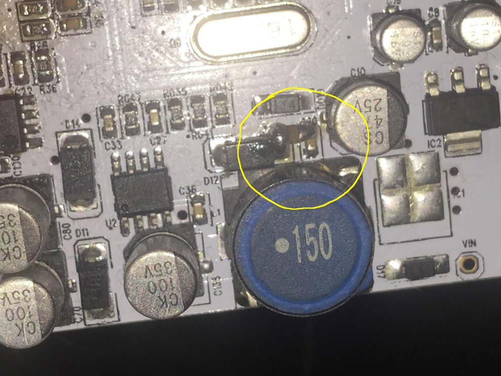

2 This is very disappointing since I thought I was getting a new board from GEEEtech. I mean REALLY dissapointing!!!!. take a look at that capacitor?? bridging a Diode?? to another capacitor?? near top of the induction coil. What??? The thing is that I bought the board a few months ago and didn't realized until issue 3 and 4 came along. Can I have it replaced? is this what is causing the other issues????

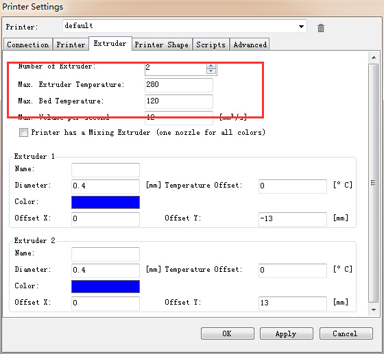

And for the MAX temp I think it is not reach to 344, it just reaches the temperature you set here:
Maybe you can try to lower the temperature about 190-210 for PLA and 220-230 for ABS.

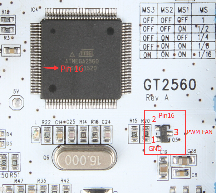

you can check the voltage of the pin16 as the picture shows. when you manually turn on the PWM fan on the repetier host, you'll get 5V between pin 1and pin2, and when tun it off, it's 0V.

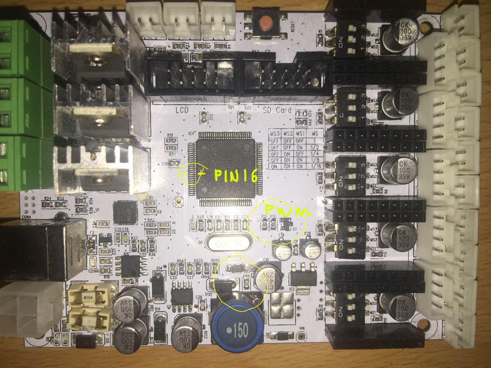

No power to fan solved.
I fixed the original GT2560 that came with the printer. No power to fans including PWM fan. It was pretty straight forward in the logic. I just forgot that there was no power to all connectors and mistakenly thought the problem was only PWM fan conn making me asume the problem was between the connector all the way to pin 16 and maybe including the atmega2560 being damaged internally. So I replaced the diode on the board from one I got from and old IBM server blade. It took me quite a while to find one in the motherboard graveyard. So the Vin comes directly from fuse to diode then + pin on all fan connectors including PWM. Part id 1N5819. I think 1N5818 can also be used. There is a Vin VIA/Test point/power output that you can use to test to see if the diode is bad.
