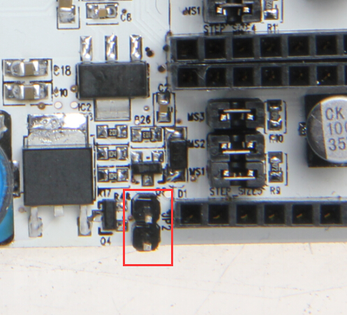

If you use 12V for power and fan, then I think it will work, and remember to plug the jumper cap here, it will turn the PWM fan on all the time, which is useful to the print job.
