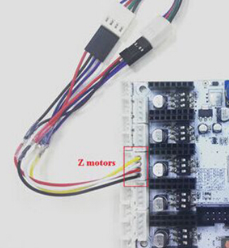

Hello, i recently bought one Ramps FD for my Prusa I3, i don't know how to wire the 2 motors on Z axis, because on board is one single Z connector

Actually you can make a "1-in-2-out" cable by yourself, but note that the power for the Z motor driver should be a little high for it needs to drive two motors.
