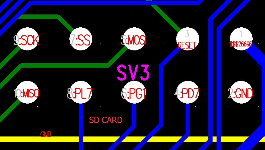

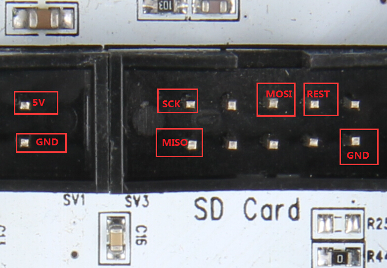

Yes exactly. But this is the old one, check the new one here:
SD CARD
SD CARD
SD PIN.jpg (262.12 KiB) Viewed 55013 times

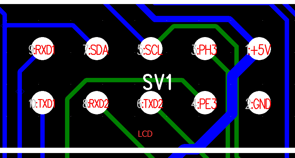

LCD
LCD
LCD PIN.jpg (262.29 KiB) Viewed 55013 times

Thanks for the info guys, i successfully managed to get this board back to life using an arduino 2560 as an isp. can be done with other arduinos
How i fecked it up.
i chose "export compiled binary" method from arduino and updated the printers firmware via repetier server. it worked the first time but the second time i chose the blablabla-bootloader.hex instead of blablabla.hex. this screwed me over.
How I fixed It.
bang head against wall, connect relevant pins (sck, mosi, miso, vcc, gnd) from ICSP header to the pins on the gt2560 board (picture from post above). (ribbon cables reverse the pinout)
digital pin 10 on arduino to reset on gt2560 (sd connetor).
in arduino (i used 1.6.8), load arduinoisp from examples and write to arduino,
choose "arduino as isp" under tools -> programmer, make sure arduino is correct com port
tools -> burn bootloader, if it says invalid signature there is a wiring mistake

@olliesmith you say you use arduino to burn the bootload again, but bootload of arduino mega 2560 doesnt have fuse settings for external oscilator (cause there isnt any for the main chip on the arduino board)!!
i tried the connetion with arduino isp on UNO and MEGA without sucess =(
now i'm working with an usbasp and kept signture at 0x620000 or 0x5e0000, but no sucess on comunication!
did you plug any out power to the gt2560, besides 5v of the arduino isp on the LCD connector?
