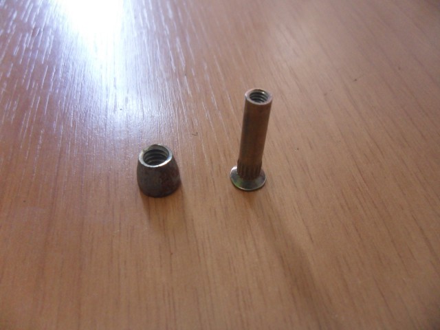

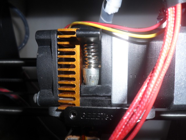

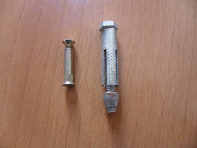

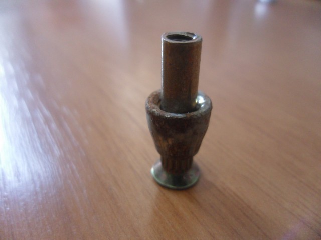

Hi!
I had similar issue with mine and it seems a design problem.
The spring doesn't provide enough pressure over the filament.
Removing the spring I see it curved.
To increase the pressure I did a small ghetto rig with things from my junk.
The main pieces are one screw and a conical nut.
See the pictures.
The screw I had to cut a small part.
Later is little hard to put the piece on place.
Too I changed the voltage on driver trimpot to 1.30 V.
I did prints yesterday during 8 hours without problems.
Let's see how many time it will work.
Best regards.

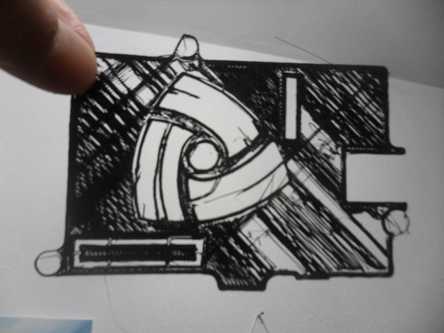

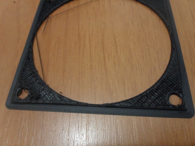

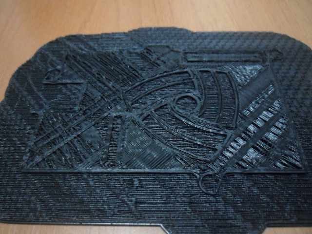

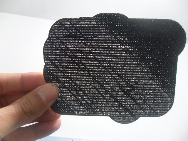

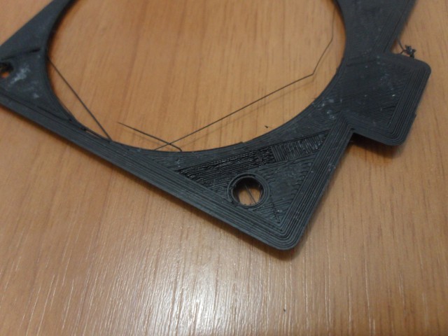

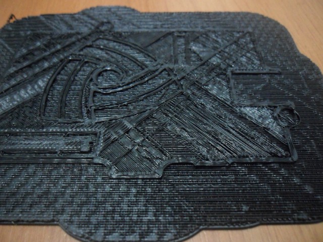

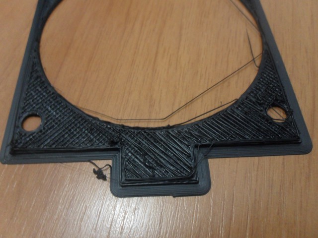

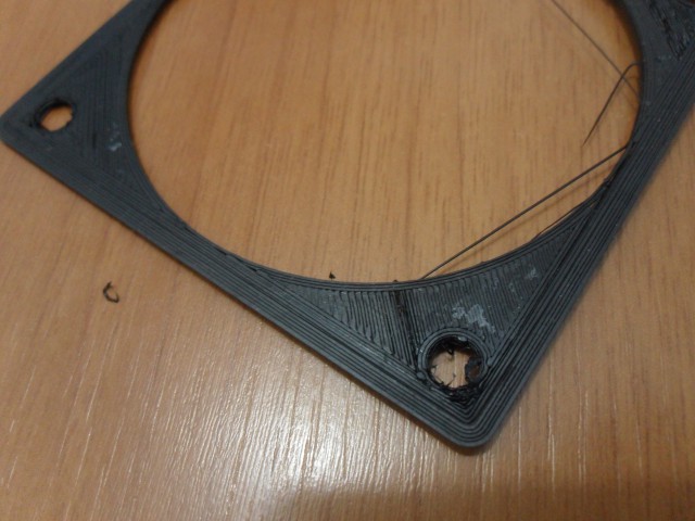

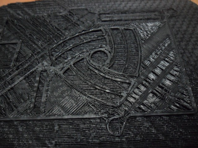

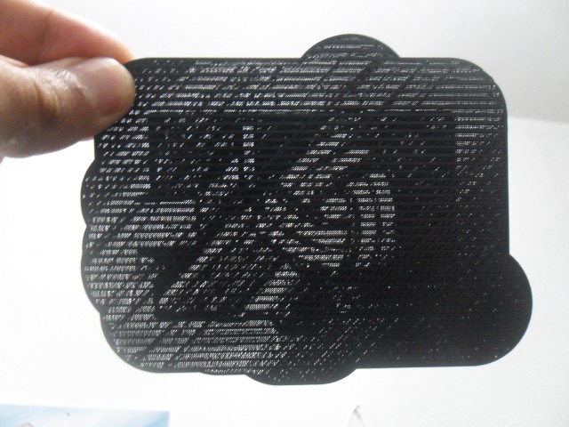

It was only a dream I have problems again. See the pictures:
This are the raft and two first layers of my print "finished".
When is printing the raft I had a fail and to help the extruder the filament was pressed with the hand to keep printing.
The extruder was not clogged.
I would like to know what the Geeetech will make to solve this problem.
Best regards.
