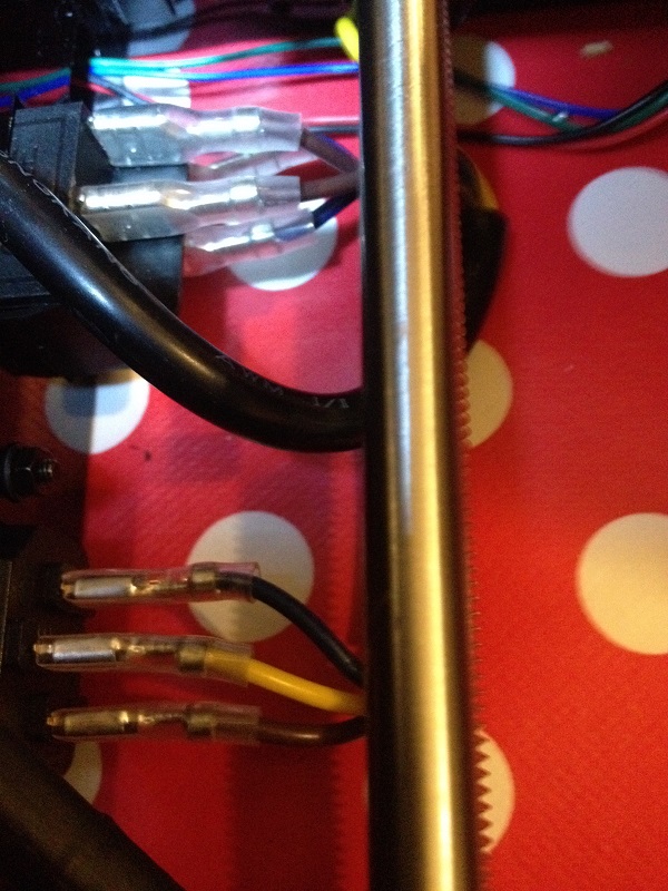

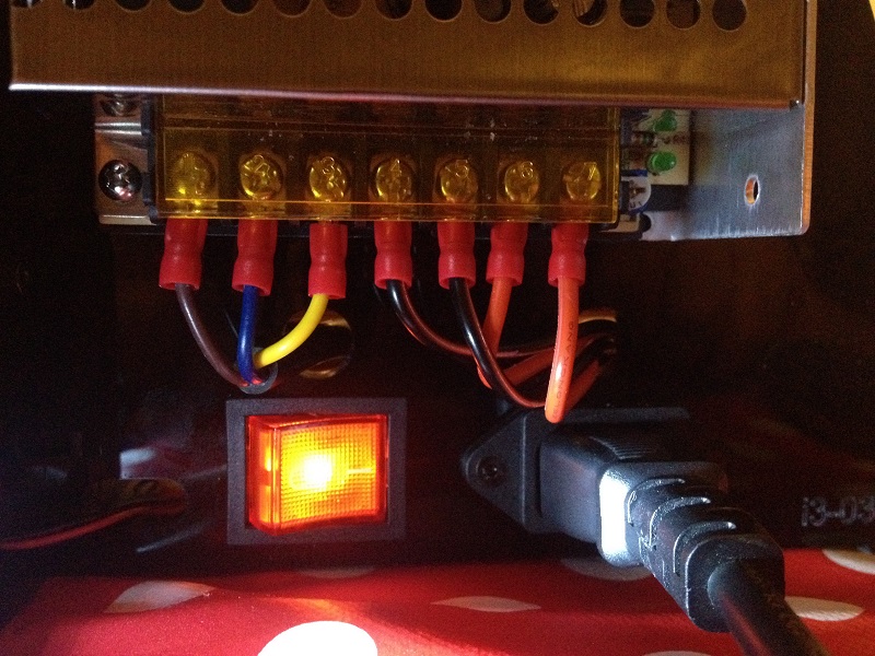

My printer died after the first successful print. This is how it died:
1) I performed a 20 minutes print
2) I switched it off
3) After one hour or so, I turned it on
4) The printer made some short move and it died (two seconds after I switched it on)
This is what I have checked:
1) All cables are correctly connected
2) The Voltage Selector is on right position: I live in a 220V area and the switch is on the 220V position
3) When checking the Power Supply Unit (PSU) with a multimeter, I can see the 220V getting in but no VCC going out (cero volts)
4) The PSU did not make any “strange” sound
5) No “magic” smoke or smell came out from the PSU
6) In the attached pictures you see the main switch on the “ON” position but the small green led on the PSU does not light on
Please advice.
Faulty Power Supply (green led off)
- IMG_7142_b.jpg (179.65 KiB) Viewed 4594 times
- IMG_7140_b.jpg (189.75 KiB) Viewed 4594 times
Re: Faulty Power Supply (green led off)
Contact the seller to ask for a replacement.
