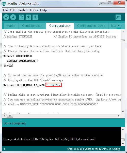

And It looks like you named your unposted sketch "main.ino" when you are compiling the code of A Pro. You can't use "main" as the name of your sketch.
Attach a screenshot like my post if necessary:
I wanna see the error message,cuz my compiling of A Pro didn't appear error.
