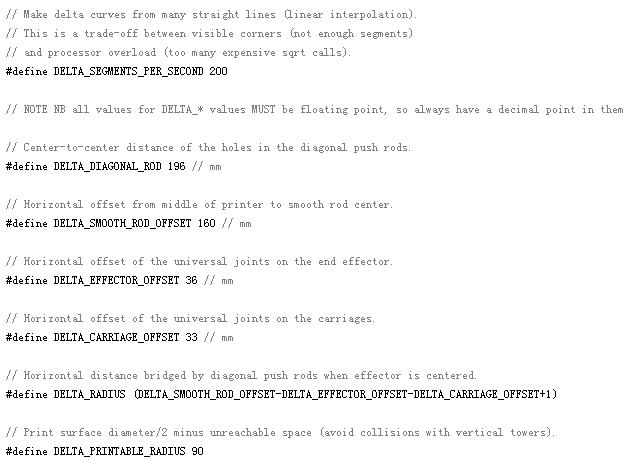

I'm attempting to confirm (and understand) the firmware parameters and settings for the Rostock 301, with the aim of improving print accuracy.
is there a document that goes into detail regarding the various settings available via the LCD?
in particular I'd like definitions for the following (or better, a diagram):
Delta: (these are the default settings)
Segments/sec: 200
Diagonal rod: 188
Smooth Offs: 160
Effector Offs: 33
Carrage Offs: 33
Delta Radius: 89
Print Radius: 90
but it wouldn't hurt to have definitions for the other available settings.
eg:
Code: Select all
section | property       | expected value/range | function/description
delta   | Segments/sec   | 200                  | linear interpolation for curve calculations.
delta   | Diagonal rod   | 188                  | center-to-center distance of holes in the diagonal push rod.
delta   | Smooth Offs    | 160                  | Horizontal offset from middle of printer to smooth rod center.
delta   | Effector Offs  | 36                   | Horizontal offset of the universal joints on the end effector.
delta   | Carrage Offs   | 33                   | Horizontal offset of the universal joints on the carrages.
delta   | Delta Radius   | 89                   | Horizontal distance bridged by the diagonal push rods when effector is centered. (Smooth Offs - Carrage Offs - Effector Offs)
delta   | Print Radius   | 90                   | print surface diameter/2 minus unreachable space (avoid collisions with towers.
If done thoroughly, it would only need to be answered once.
Also, the firmware for the 301 is closed source and belongs to Geeetech, so someone must know which G-Codes are supported.
Delta | Diagonal rod | 188mm - 200mm | length between eye-centres for diagonal connecting rod
Are you looking for this?
The setting i attached is G2s.
Jambon
Posts: 3
Joined: Sat Sep 24, 2016 2:43 pm
Re: Rostock 301 Firmware Settings
Post by Jambon »
Thanks, I've updated my original post with your information.
I hadn't thought to look at the source for the G2 machine firmware, obvious now.
I'll take a look there for clues to the other settings meaning and update the above as and when.
