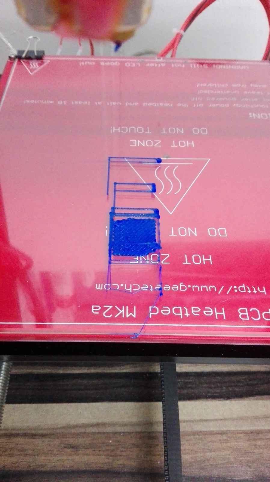

Hello today i habe build my Geetech Prusa i3 Pro B.
All is fin but if i like to print an cube from thingivers th prints are moved on the y-axis by changing the layer.
I use S3D for printing the stl file.
Any idea?

- IMG_20170116_150159.jpg (466.2 KiB) Viewed 10835 times

Your Y axis has a layer shifting.
Check if the motor on Y axis was losing steps or the bearing on Y smooth rods is hard to move(spread some lubricating oil on them).
Additionally,check the belt on Y axis is too loose or too tight.

Hello Cup,
thank you for your answer.
Yes the Belt was to loose.
I have fix it and now i can start to print.
