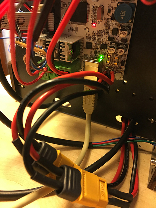

I had the same issue happen to my Prusa I3 Pro B. When printing PLA I had no problems but as soon as I tried to print ABS it looks like it overloaded the circuit. I read there are two solutions...

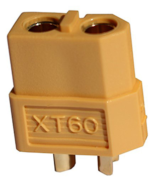

either desolder the old 4-pin connector and solder wires directly to the board and use XT60 connectors
or

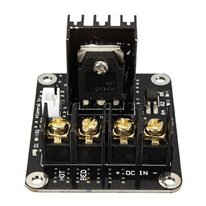

buy a MKS MOSFET - which requires no soldering and bypasses the board altogether.
I chose the former because I'm okay with soldering. (Be warned it is a delicate operation.)
You'll need 2 male and 2 female XT60 connectors.
mks MOSFET power expander
