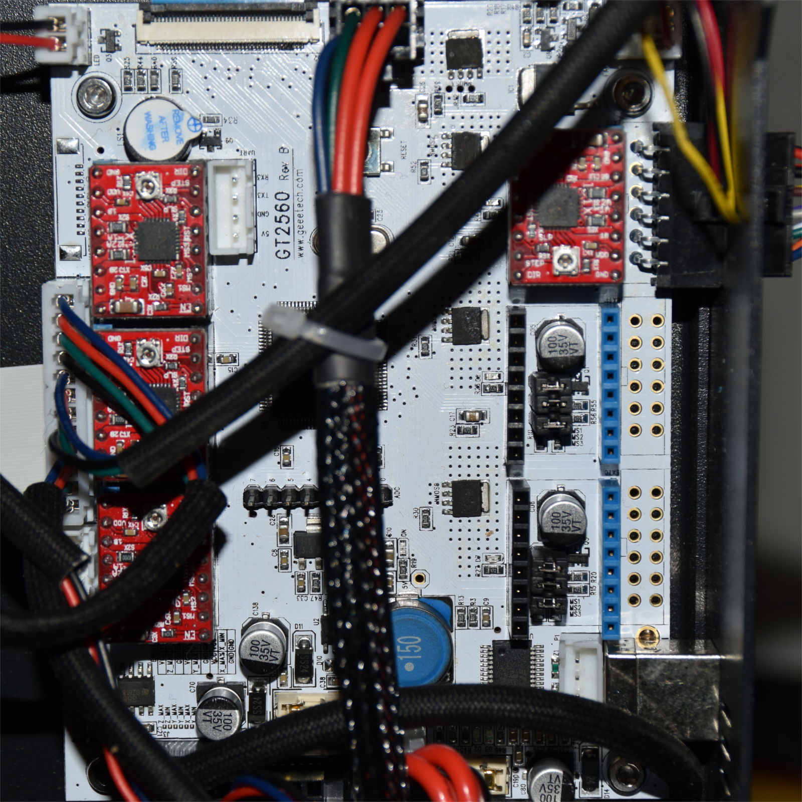

I checked the connectors off the motor and on the board and they are all correctly plugged.
I also measured the voltage of all of the drivers and they are all between 0.8V and 1.2V as recommended.
Below is an image of the board, maybe this helps - beside that, which of the drivers is responsible for the Y-axis? I thought about swapping it with another to see if the problem persists.
