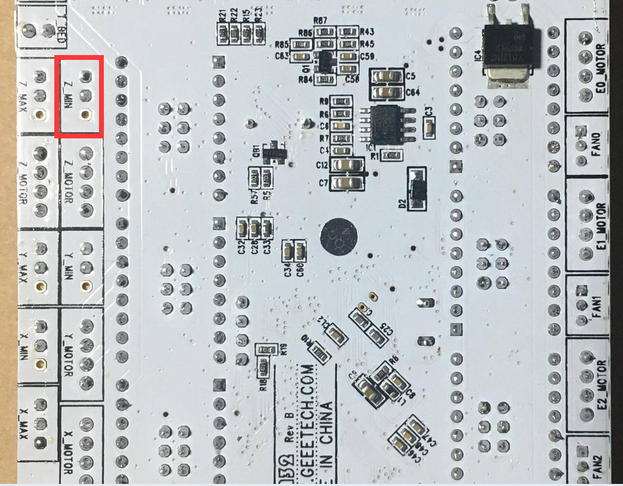

Re: M201 Crushing Z endstop with lead screws
Hi,before you get the replacement,I think you can resolder this place on the back board.There might be some bad weldings.
Here is the pictures.
