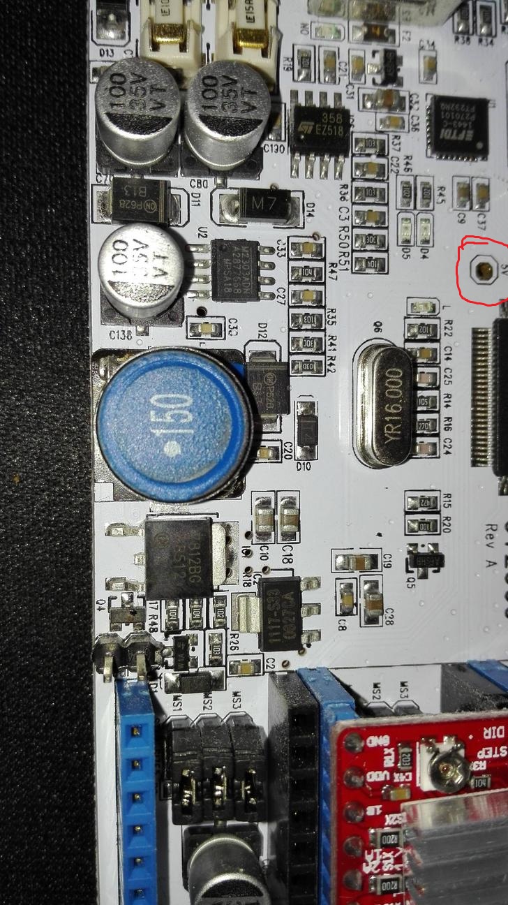

Others have suggested that the voltage regulator that regulates 12V down to 5V on the GT2560 is broken, since it still powers up via USB. So now I want to replace it, but my question is, which part is the voltage regulator? On this picture: http://imgur.com/a/nB2Ho it should be the part that reads 7812BG RB512 right below to the big blue coil, is it? But I am not quite sure, my electronic skills aren't that great...
Can somebody post a link or a part number to the right part that regulates the voltage?

Ok, it wasn't the Voltage Regulator, it was the 10A fuse. It blew but it wasn't visible. I measured, and it doesn't work (high resistance). Off to buy a new one!

I have marked the testing point with red circle in the picture.
