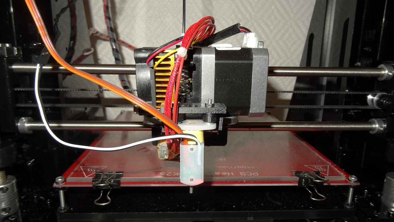

Configured Marlin 1.1.4 (latest to date) to work with Geeetech Prusa i3 Pro B, with 3DTouch probe mounted... Comment probe section in Configuration.h if you don't need BLTouch...
Still configuring probe so cables not guided ^^

Issue G-Code : M851 Z[My offset like -1.4 for ex.] followed by M500 to save in EEPROM... I recommend to test and print some lines to really adjust correctly and definitively the offset between the hot-end and the probe (mounted with printed part from Geeetech)...

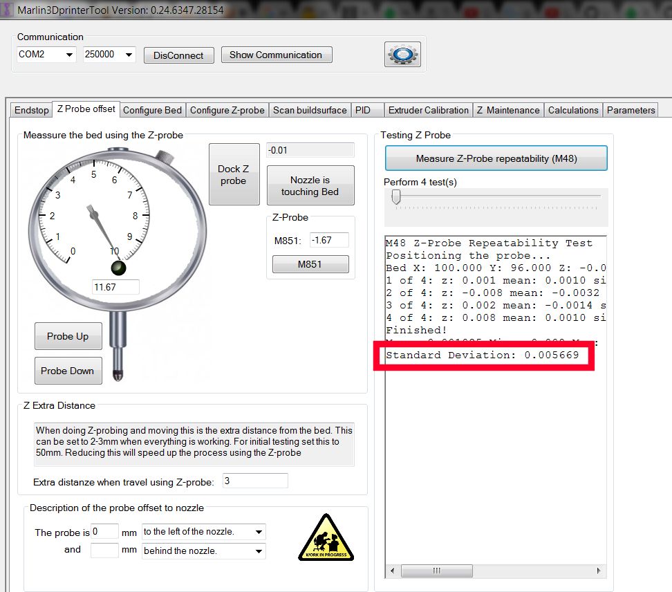

You can tune your probe with screw adjustments to get the most accurate settings from it... But this is a very long process. Don't forget to oil correctly all Z axis moving parts to get the smoothest movements and use M48 repeatability test to get the smallest deviation possible (near <= 0.01mm). I don't need to explain that your bed surface need to be also well cleaned...
Procedure to do this (probe in up position, turn your screwdriver very gently):
- unscrew the top screw until probe flash alarm.
- Reset alarm (G-Code : M280 P0 S160)
- Screw until the light pops on (this is your near best starting point to fine tune next)
- Launch M48 repeatability test procedure
- fine tune the screw until Z bed position is the most near 0 and your derivation <= 0.01mm (less is better)
I glued with a glue gun the probe's screw after getting the best results for 4 consecutive tests (probing 4x4 times), I am almost sure it won't budge... I am below 0.01mm deviation, so this is excellent.
Here, after 2 hours of settings (this is a patience game), I can get this :

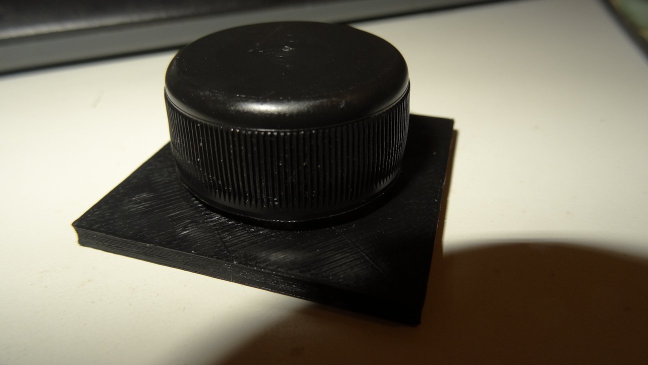

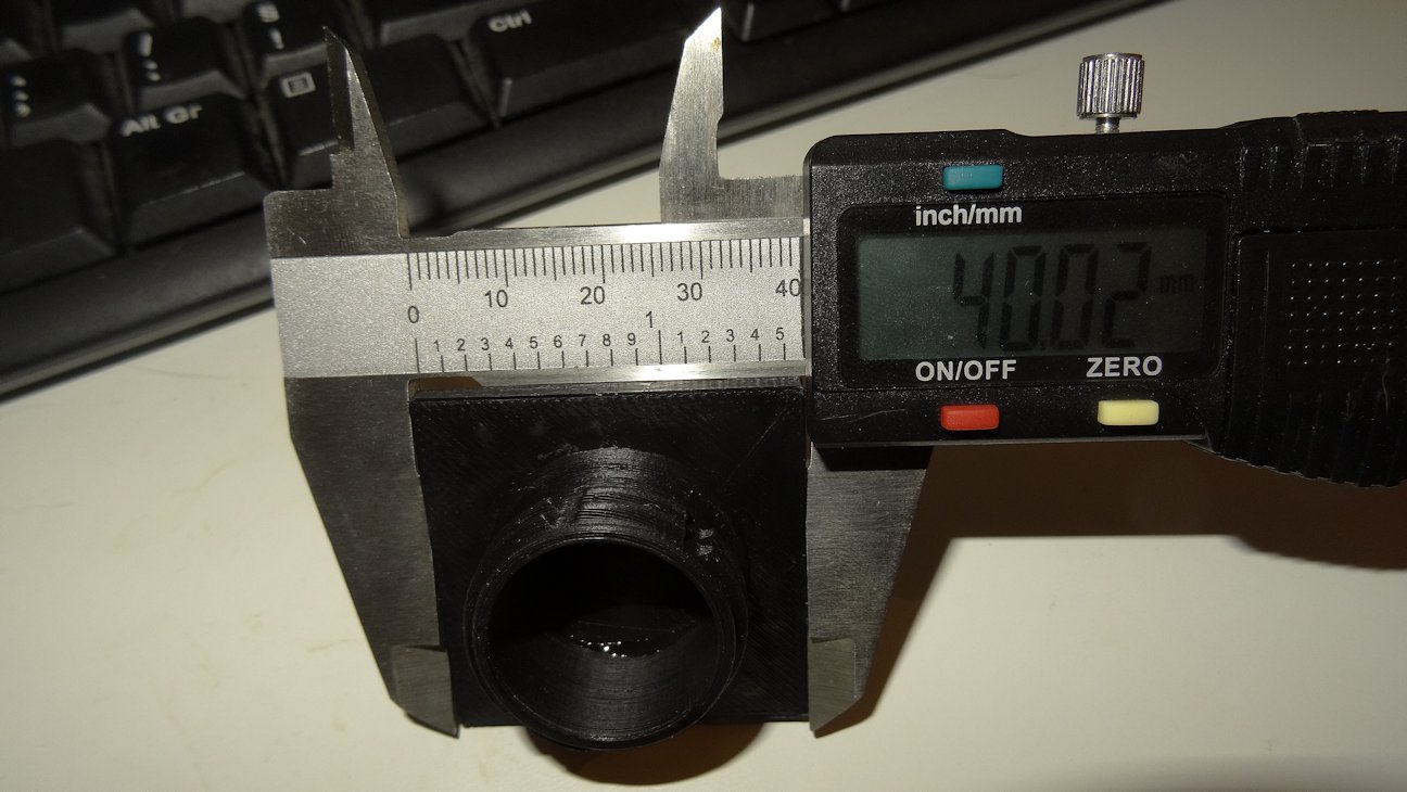

I defined steps with these values for my printer, so adjust them to your needs if you want... (you can do this from LCD panel) With these values, my printer prints ABS within 0.05mm precision in all directions ^^ Here I have printed a test of my bottle neck design for any soda bottle cap like Pepsi (perfectly sealed with water inside ^^) on a 4cm square plate = 0.02 drift without sanding finish :
Pepsi cap screwed
