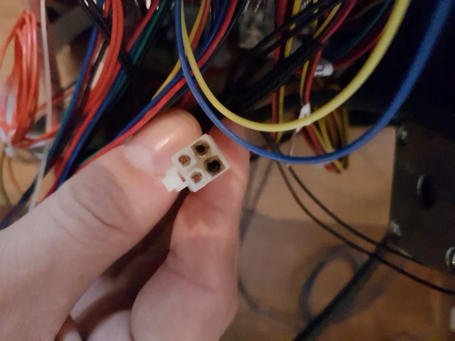

While i examined the problem, i saw that my power connector on my GT2560 Board is burned/black. I uploaded a photo of the power cable. Is this normal? I measured the voltage of my power supply and it says 11,97 V while running the printer.

You have better to test the voltage when the problem happened ,the black power connector indicates that it has overcurrent ,what is more ,the problem you meet is similar to what others have met too ,you are able to have a try changing the usb transmission line or SD card.

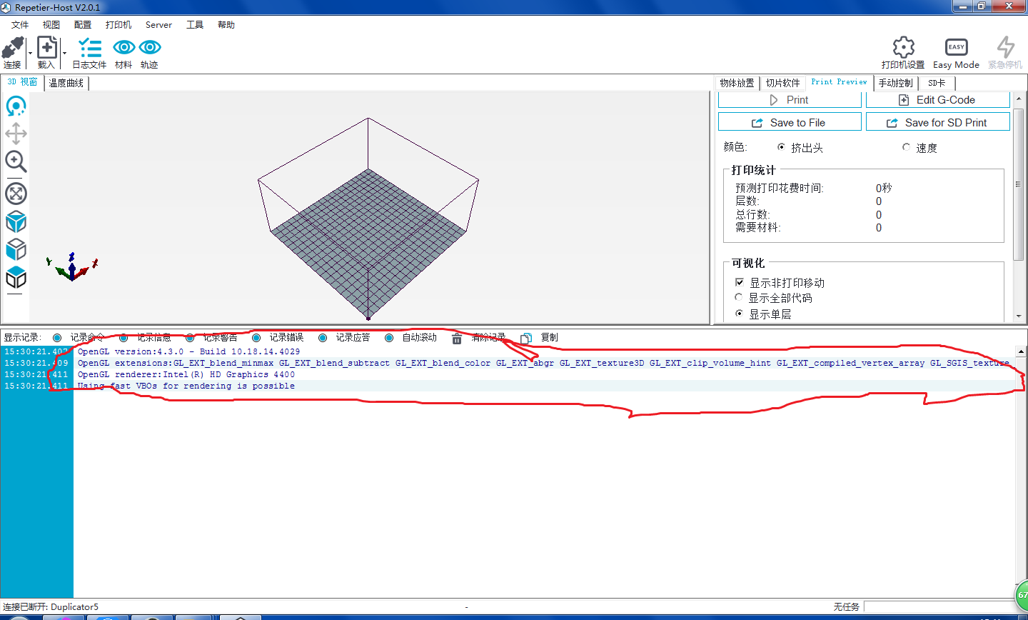

Do you print via Repetier or Easyprint or SD, could you show me the faulty recorded in the journal,I want to find
where is the faulty.
Re: Printer goes off/restarts while printing
Most of the time i print via SD card, because i dont want to run my PC over night. But I use Repetier to create the gcode. What do you mean by "journal"? I tried to google "Repetier journal" but didnt find anything useful. Do you mean the temperature curves?
as shown in the figure.

But the burned power connections àre still remaining. The socket on the board an the plug are burned.
And now it looks like the power plug is burned/molten. The plastic seems to dissolve. I feel like it is no longer save to run that printer without i am being around it.
You said it is a common problem? Why isn't that fixed? Does Geeetech replace this?
... While i am writing this... my printer went off again.
I copied the logs:
https://pastebin.com/gWv38tzD
It went off around 11:27:40.725. The board thinks it is printing like normal, but the servos are not moving.
I think its the heavily burned cable and socket. I touched the cable slightly and the printer went on again. I think the connections are burned out.
Next question: Why is this so? Why is this burned? Is this a bad electronic design? Is there a geeetech warranty?
I mean, I am capable of desoldering the socket from the board, and chrimp a new plug. But what next? Do i have to replace the connections every 6 months?
