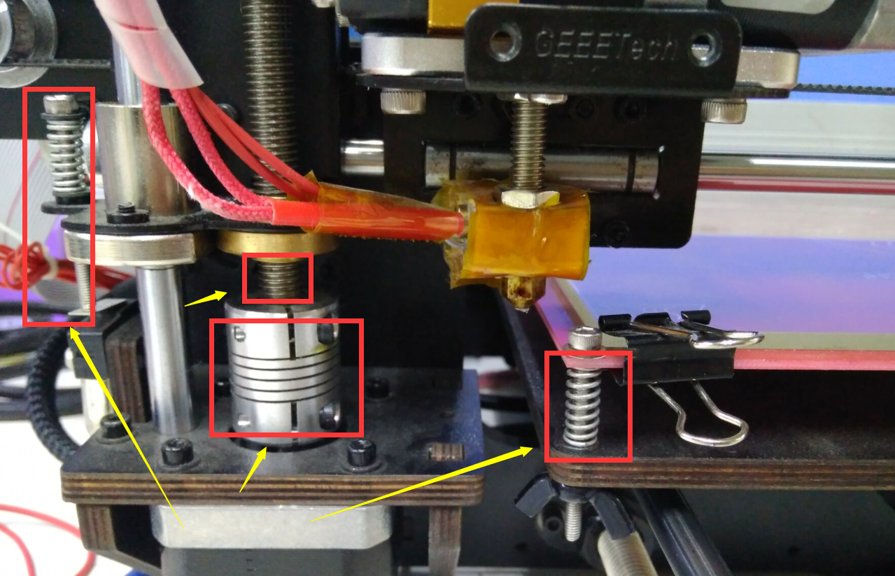

I think you can check four parts of the printer(In my picture marked four area).

Hi there, first post here, so hello everyone!
I got a Geeetech i3 Pro B Acrylic kit for Christmas, and spent the last few days building and tuning it. I had the same problem! The instructions say to use an M3x30mm screw in the end stop trigger, but that is far too short. What I did was go through all the pieces leftover at the end of the build (so many of them... why???) and I found a black M3x45mm screw and just used that (I think there were two of those). It still has to be threaded quite far (I had to cut half of the spring off, since it was blocking the screw before it touched the trigger), but I managed to get it working.
In all pictures I see on the Net, there's a silver screen in there. One of the leftover packages had a silver M3x40 screw, which I thought could be used for this purpose, but it was still too short.
Hope this helps!
