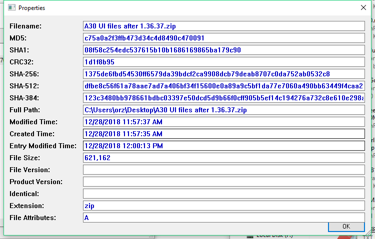

MD5:

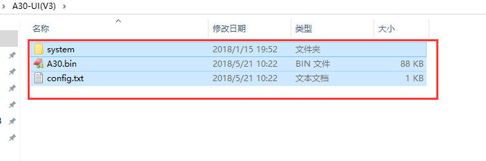

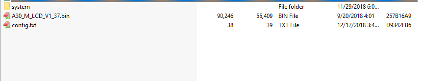

3.You need to delete the old A30 UI files on the sd card
4.You should copy these unzip files to the root of the sd directly
LCD UI-1.png (10.42 KiB) Viewed 44691 times
6.Re-insert the sd to LCD sd card slot.Done!

Okay, I just managed to open the rar files... and it took me a while to realize, that you have to store them on the internal SD. Not the removable one^^.
