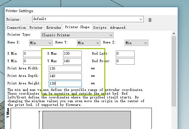

Logically, you can change the printing area with repetier host accroding the real size of printing platform.
If you try it one day, I'd like to know whether it works. :D

Have you edited the print area?
Try to print an object in 10*140*10

Gingko wrote: Mon Jun 11, 2018 5:02 pm Have you edited the print area?
Yes, but not works.
I modified x y or z offset, but don't work. I don't know if I need a combination of variables. :cry:
