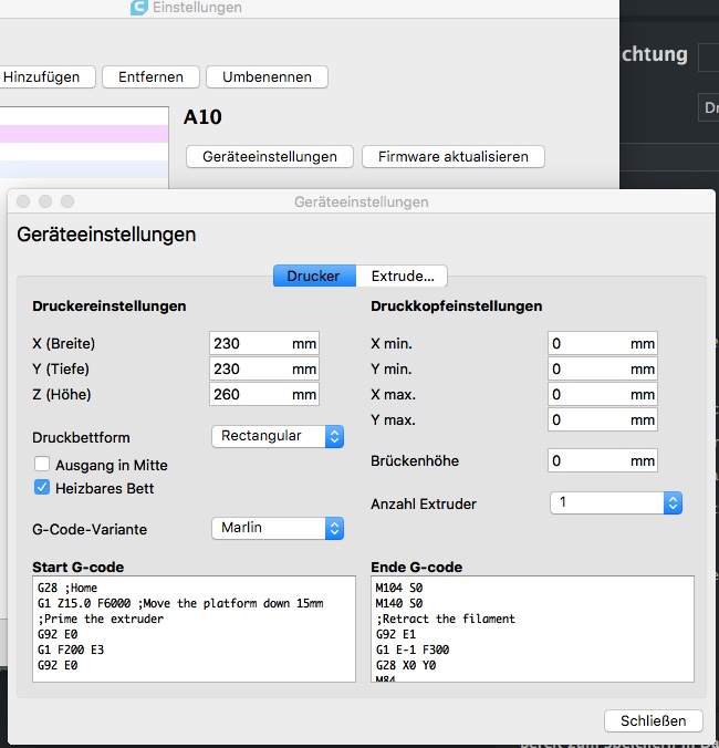

Printersettings in Cura.
Left side: heatbed
Right side: Postion from the extruder

Post by Tyrant »
thanks ,
i'll try this , my heat bed is just over 220 , so i'll modify the numbers to reflect that.

ok, Tried these settings , prints still way off to the right on the heat bed and off it.

Post by MichaelK »
Tyrant
Posts: 10
Joined: Sat Aug 25, 2018 7:35 pm
Re: Centering A10 Printer
Post by Tyrant »
Thanks Michael , this will help !! , it's getting there now , appreciate the help!!!!
