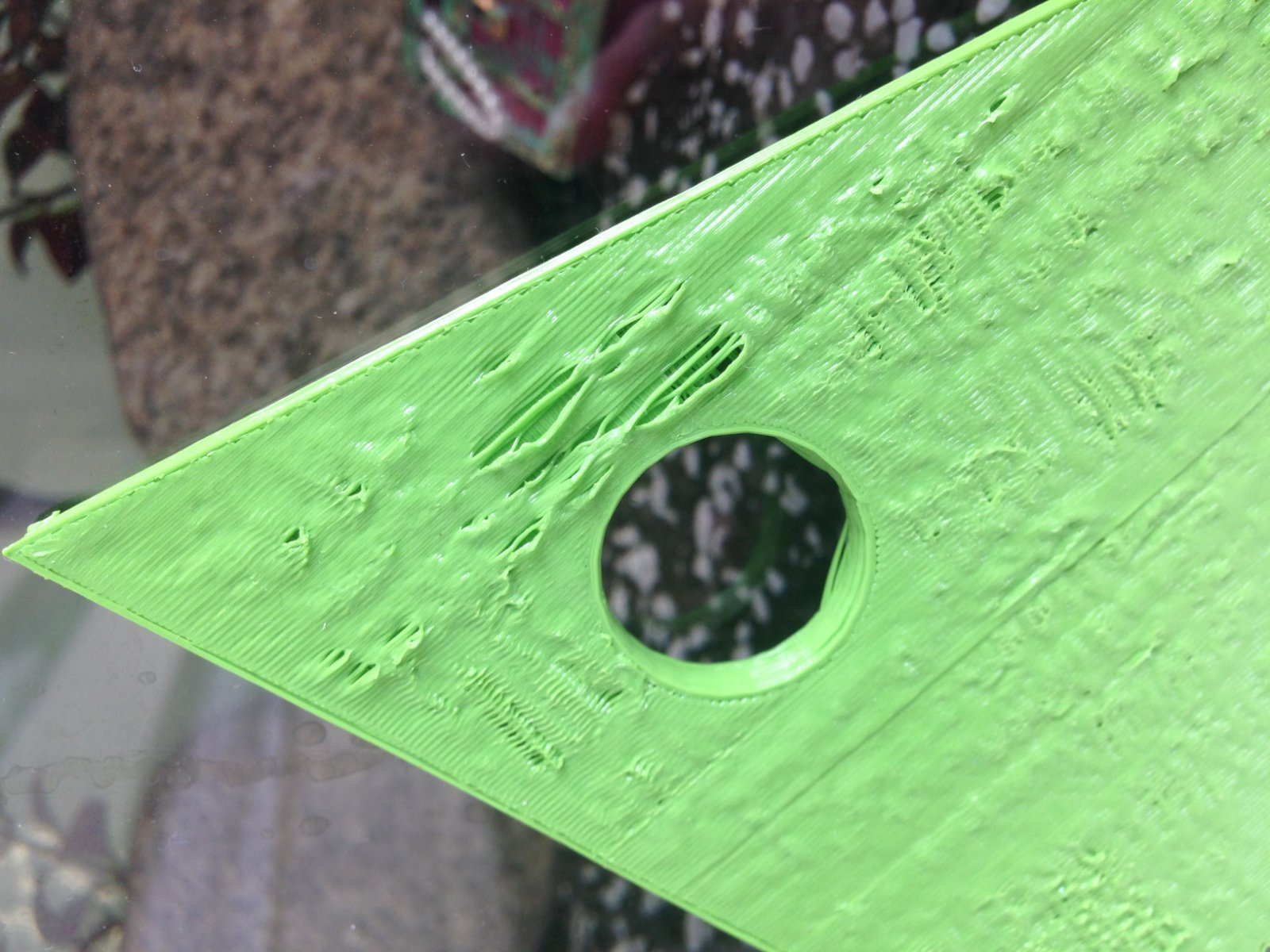

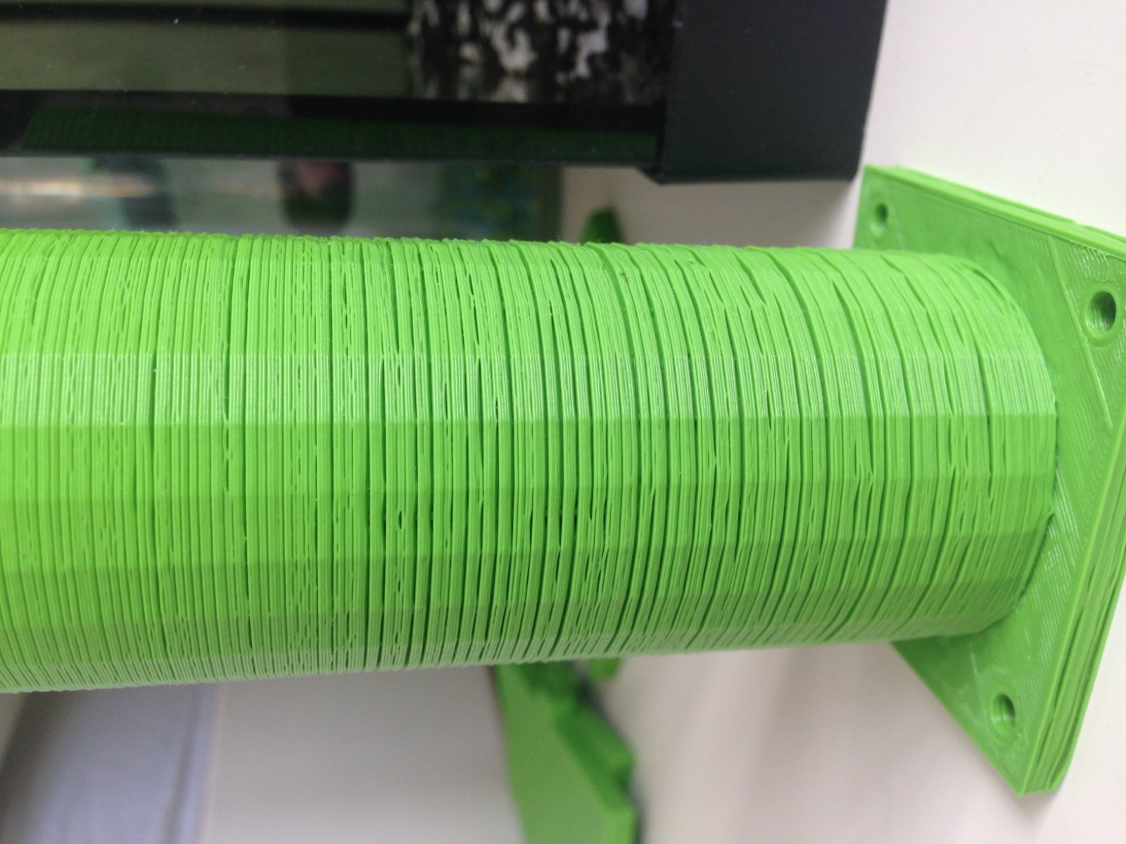

hi i have a problem with the print quality. does anyone know what i could do to resolve it.
- IMG_1498.JPG (252.37 KiB) Viewed 7639 times
- IMG_1499.JPG (281.01 KiB) Viewed 7639 times

Re: print quality
How much did you set the nozzle diameter and layer height?
Did you calibrate the E step?
Re: print quality
thanks for replying. i set the nozzle diameter at 0.3 mm and the layer height at 0.35 for the first layer then 0.3 for the rest. i haven't collaborated the esteps and i don't know how to.
Re: print quality
You can try layer height with 0.15-0.2mm for other layers, 0.2-0.3mm for the first layer.frog0 wrote: Sun Aug 19, 2018 12:59 am thanks for replying. i set the nozzle diameter at 0.3 mm and the layer height at 0.35 for the first layer then 0.3 for the rest. i haven't collaborated the esteps and i don't know how to.
How to calibrate the Estep?
https://www.youtube.com/watch?v=LzZZaGmeX8w
How to change the Estep value?
Use Gcode M92, try to search more information about step/mm change in the forum or Google.
