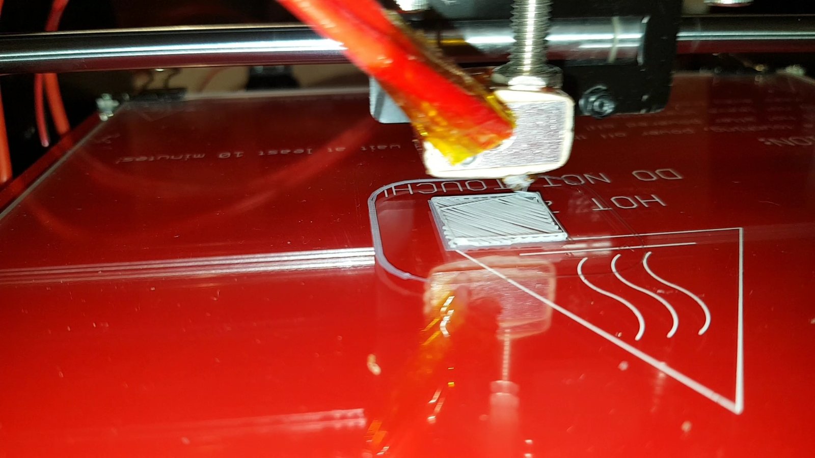

Hi all,
just built the pro b prusa i3, nothing but major issues.

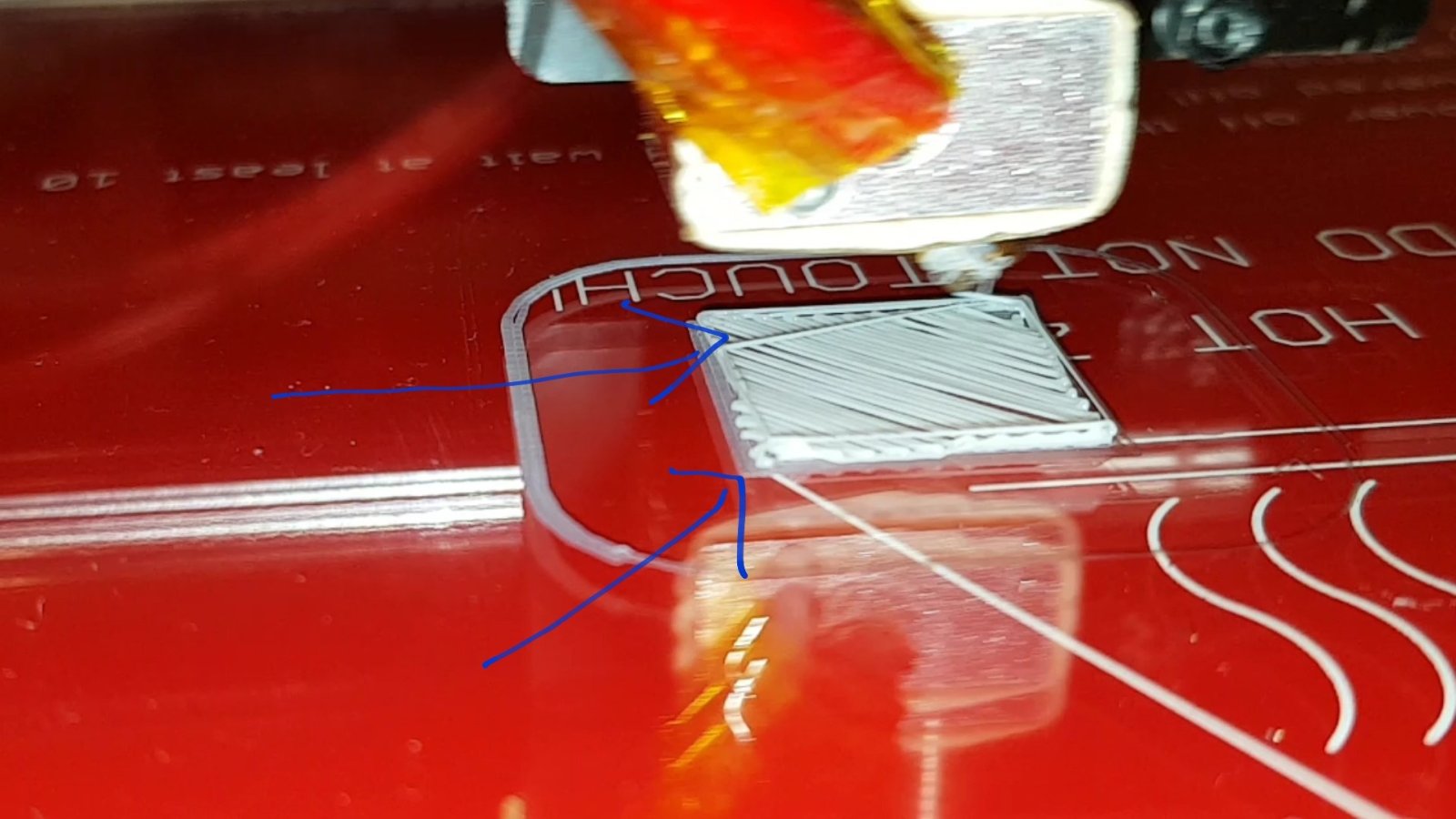

When i print the first layer is ok kind of (has gaps in lines).. but the 2nd layer the filament SKIPS THE CORNERS OF THE SQUARE (see pics) this is the biggest problem i have... i can live and deal with the gaps.
PICTURES AT BOTTOM OF POST AND VIDEO HERE -> https://youtu.be/SXXeyrCHvJo
i have leveled the bed to a piece of paper under each corner or on the bed touching.
I have calibrated the extruder
the z steps are out but not over, they are under
settings
0.3 nozzle (it is 0.3 nozzle)
1.75mm pla - 1.75 in slicer settings
extruder tmp 205, bed 65
first layer 0.1 layer height 0.1 (also tried 0.2 on both, and 0.05 on layer height)

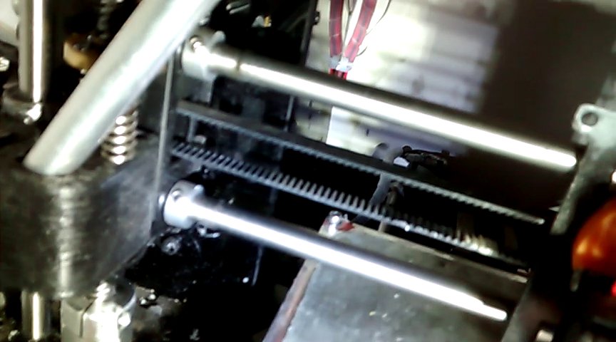

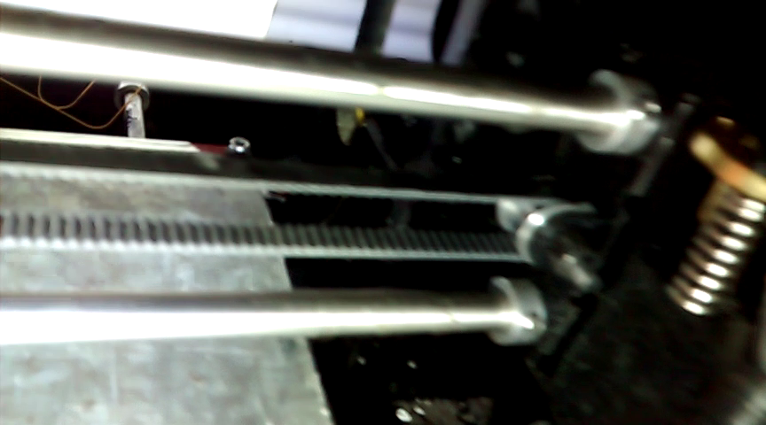

I also have the z axis issue where if i put the top piece that holds the z axis in place on one side it makes noise and doesnt move.. this has to do with the x belt tightening pulled the z rods together.. i have managed to get this to work with just a little noise every now and then.
Help mostly with the first issue would be great thanks
VIDEO - https://youtu.be/SXXeyrCHvJo

The Z step seems not correct, it goes up too much so that filament cannot attach together. You can make it move 100mm, then measure how far it actually goes, test for several times, then calibrate the proper Z step/mm.

Yep, this is a minor issue.
Correct the z-steps, for me it was around 405. You can do this in the menu and DONT forget to save it (store) to the EEPROM!
By default it's around 2600, way too much.
Layer height can be 0.2 or 0.25 mm (for the 0.3 mm nozzle).
While you are at it, make sure to also calibrate the extruder (e-steps), default is 100, I had to slightly decrease that. Google/youtube on how to do that.
"I also have the z axis issue where if i put the top piece that holds the z axis in place on one side it makes noise and doesnt move.. this has to do with the x belt tightening pulled the z rods together.."
Had the same for me, make sure the Z axis horizontal piece is "wide" enough so that the rods can EASILY rotate and not stuck. Try to adjust it.

Then the proper Z step=recent z step(2560) * 10 / 14.5=1765
Try to set this value as Z step, then save it!

Second problem - Incorrect assembly
The x axis rods must be retained on the inside of the carriage with the retaining locks - the retainers need tio be pushed up hard against the carriage supports so the rods prevent the belt tensioner pulling in and bowing the z axis rods.
Be careful of one of the frame screws on the RHS it fouls the RHS carriage as it goes up
